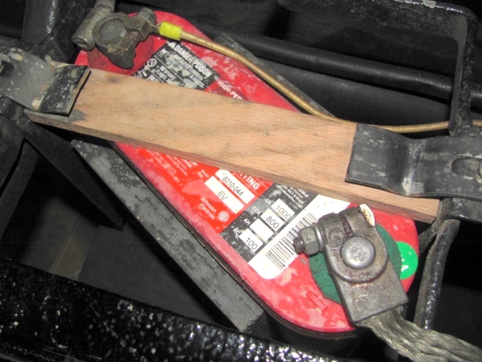

I've had no issue with keeping the charge up on the Optima Red Top 6v with the Model T generator. I keep the gen. output just under slight discharge on the dash ammeter with the lights on and running at a quick idle. But I do use the Voltage Reg.
On the stored Ts, about every couple of months put a float type low amp trickle charger on those Red Tops, and within 3-6 hours they are topped up.
To me, the Optima is the best no-maintenance 6v battery around and worth the price.
Charging Optima RedTop Batteries: 6V
These batteries are designed for engine starting applications. They are NOT recommended or warranted for use in deep-cycle applications.
Recommended Charger Battery Fighter 6V Charger
Alternator 6.65 – 7.5V, no amperage limit.
Battery Charger 6.9 – 7.5V, 10 amps max, for 6 to 12 hours.
Rapid Recharge Max 7.8V (regulated), no current limit as long as battery temperature remains below 51.7°C. Charge until current drops below one amp.
Float Charge 6.6 – 6.9V, one amp max current, time indefinite (at lower voltage).
