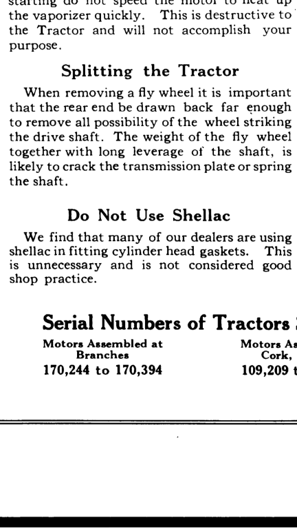

From the FORD T service bulletins; Was in the tractor section but applies to cars as well:
By “shellac”, I’m sure they are referring to any type of coating. FIFTEEN MILLION T’s were assembled with no coating on the head gasket…
