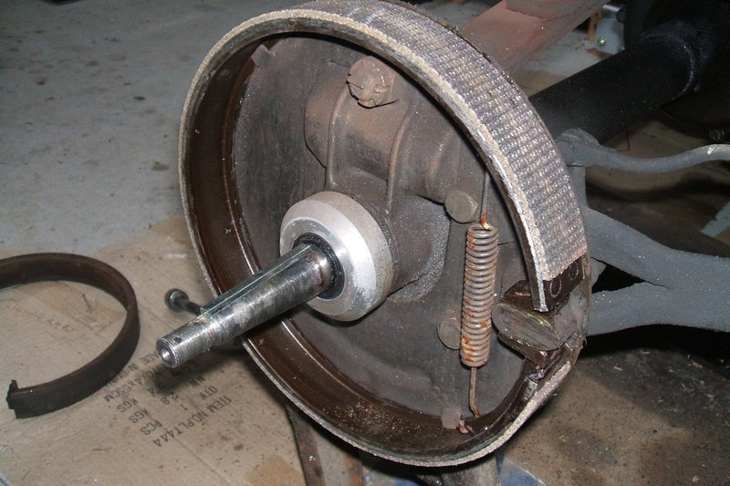

There are 4 brake shoe clips (A in the left picture) that are riveted to the round backing plate that holds the brake shoe centered and against the backing plate. It is common for the curved portion that holds the shoe in place, to wear through until they break, leaving nothing to hold the brake shoe in place, allowing the brake shoe to drop and rub against the brake drum. That may be your problem. I have attached a photo of one of the clips. These are sold by Snyder’s, Part # T-2560-CL. Size-wise, they are only about 1” long x 1/2” wide. When I restored my rear end, all four of my clips were broken so I bought new ones and riveted each one in place with 2 pop rivets. Jim Patrick
