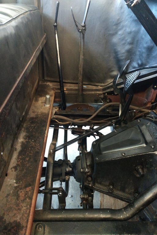

Consider a left side shifter. I make em from a second parking brake assembly. The lever sits to the left of the current parking brake lever. Way out of the way & can be made to look like an extra factory lever.
Left side shifter
Left side shifter

Consider a left side shifter. I make em from a second parking brake assembly. The lever sits to the left of the current parking brake lever. Way out of the way & can be made to look like an extra factory lever.IMG_20210627_191559462 (1).jpg
Definitely something to consider, thanks. I've seen that setup and it's much more convenient for shifting. Makes better use of the interior space, what little there is.
