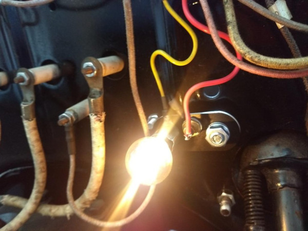

The unit installed on a 24 T

by Oldav8tor
I forget what bulb John Regan uses but at idle it is so dim you have to look hard to see if the filament is glowing. It never seems to reach full brightness when I play with the throttle. I have checked my magneto output with a "St. Louis Electrical Works" Mag checker and it's output is normal. In the unlikely event the diode should fail closed, the light bulb will quickly burn out, protecting the magneto.
Note: You want to be very careful to route the spark plug wires such that there is no chance of a spark jumping to the charger circuit. John is very careful to warn people about that. The photo shows how I routed my wires. It also shows how dim the filament is at idle.
