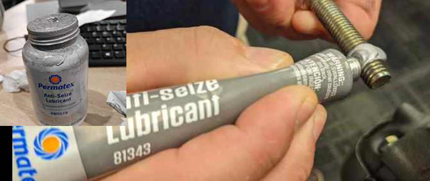

Doesn't that goo look like anti-seize, they way it sticks to fingers etc

It does, but, Why would there be 2 tubes worth in a motor??
The grey color is commonly indicative of iron shavings from the cylinders. Chrome molly rings? or just the lack of lubrication.
Some is expected to be caught on the transmission screen magnet in a new motor, but decreases to negligible over time.
