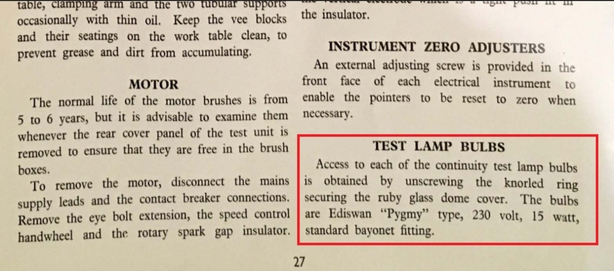

Check your bulb from part 2 of the instructions link
Given that the product was manufactured by The Armature Manufacturing CO., Ltd.. Middleton Road, Oldham, Engling, UK
I assume you got this in the UK. The OK has been 230v as is Europe. The main tester is is 230v The growler a continuity tester has a bulb < evidence 99.99999% 230v
Impressive looking machine
