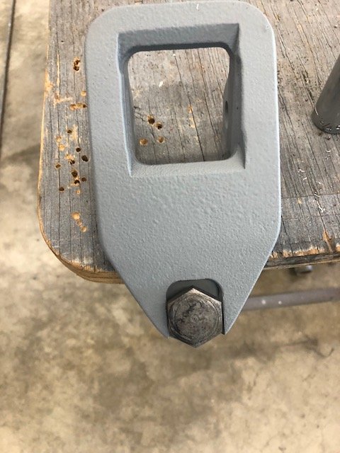

Only if you have a machine shop at your house and all your chores are done! "Nothing is impossible if it can be imagined".., N. Tesla

Other options for Rocky Mountain Brakes...., Smooth.

As a mater of fact, I do have a machine shop in my home, but my chores are definitely not done! Do you have drawings for those?

I was going t mention that I was fortunate to have Hank make me a set. Then when someone else was looking for a pair, I decided to give mine up and Hank was happy not to have to make another pair. I regret having done that. Anyway some pictures of the perch mad for large drum. They are not cast!
