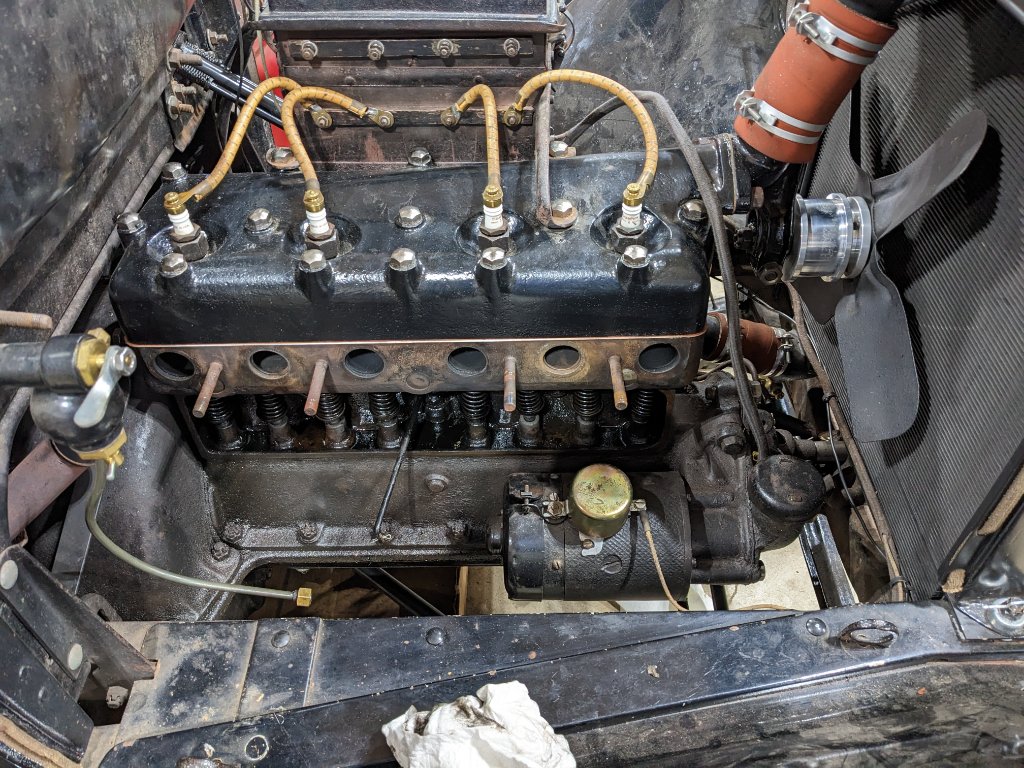

by Mark Nunn
My front 2 sparkplugs were black as can be. The 2 rear were clean. I removed my intake to check for leaks or blockage and discovered that there were no gland rings in the manifolds. My intake was installed with it shifted 3/8” rearward, partially blocking ports. The exhaust manifold is warped badly and could be straightened. But Birdhaven has them in stock and I get next day delivery. I took the opportunity to replace the cracked head that was on my car with one that shows little use.
I cleaned everything and took a lot of measurements. The good news is there are no cracks, cylinders are bored .025” over and look good. (I have good compression and do not suspect worn rings.) The bad news is plentiful. I have 2-piece valves with worn guides and stems. Their replacement will be a project for next fall. I measured total valve lift using a dial indicator. Lift ranged from .170” to .189”. Yeah, that’s what I said too. Valve lash was up to .045”.
I decided to try peening the worst offending valve stem to see if I could lengthen it. I managed to add .008” after about 20 minutes of careful pounding. I guess it would take an hour to bring the lash to within reason. I did not proceed further since valves will get replaced. I put a brass spacer between the lifter and valve stem to measure cam lobe lift. The cam lifted .215” pointing to .035” of lobe wear. That needs to be replaced too. At this point, I just want to get the car running well enough to putter around this summer.

by Mark Nunn
I finished reassembling intake and exhaust systems, which had been installed without gland rings to properly locate them. Both manifolds had been shifted rearward with the intake 3/8” off. Wow, what a difference! My test run was on my long uphill driveway. I had been able to get into high going up but never accelerated even at full throttle. This time, it accelerated so much that I had to throttle down since I was going about 25 mph! I’m excited by the increase in torque. I drove through some nearby hills, some of which always needed low and now she just putters up hills with ease. It was a fun drive. Now I need to shift the muffler forward a bit. The new exhaust manifold position pulled the pipe partially out of the muffler and is really loud now. Maybe I will just leave that alone for now and annoy the neighbors. :D
