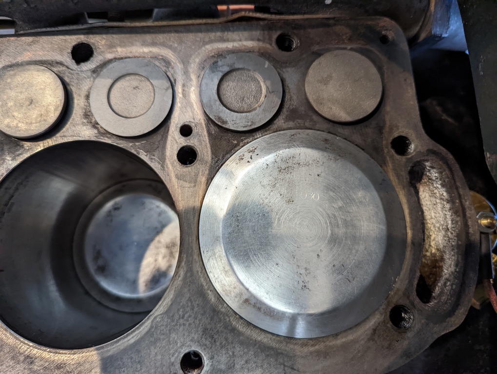

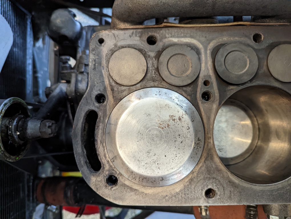

Have you looked very carefully for any evidence of piston scuffing or scoring? Check both the upper and lower bores. The lower edge of the piston skirt in the second picture looks odd. Is that oil?

The pistons appear to be a good tight fit in the bores, which is good. However, the overheating incident last August could have led to some scuffing or light scoring of one or more pistons, which could cause a sound like that.
A Z head would certainly raise compression, but it's still very low for an engine running on 87 octane gas, and at idle or anywhere near it, the effective compression is very low due to the throttle being nearly closed and thus the intake manifold pressure and actual compression pressure being very low.
From here, it sounds to me like a mechanical issue, probably a minor one.

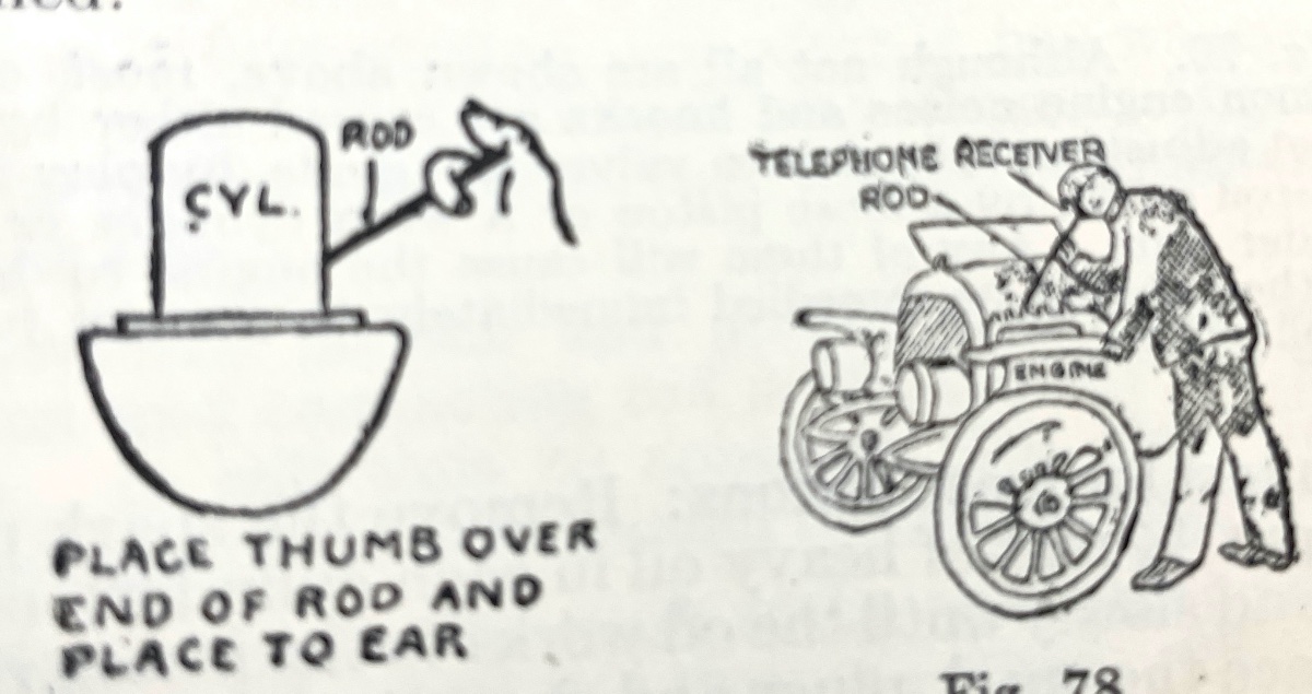

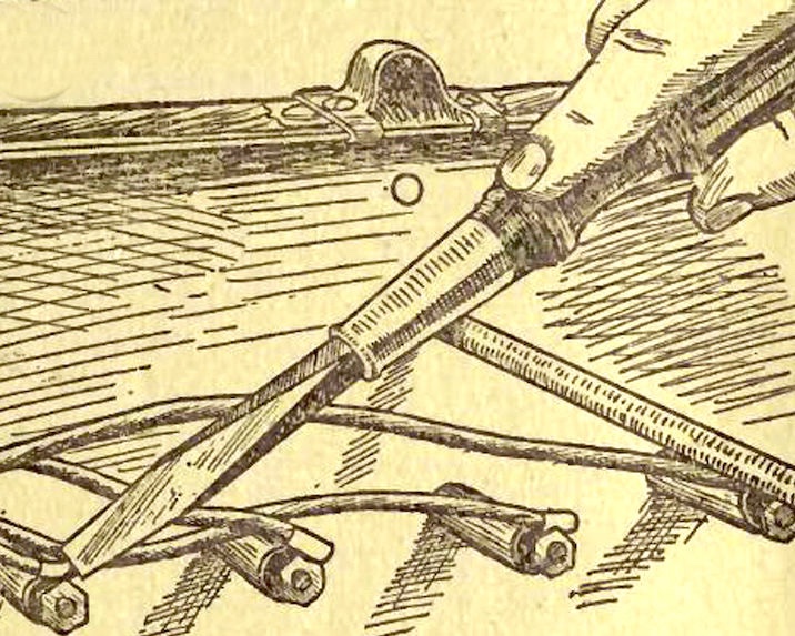

You might try to isolate the sound by shorting out one plug at a time. Either ground at coil terminal, or at the spark plug. If sound will diminish at one plug, might check out that cylinder.
Or other isolating means is to use a metal 'sounding rod' or a long heavy screwdriver with shank all the way thru the handle, grasp that rod with hand and thumb over one end, and rest your ear on that thumb, with the other end of the rod resting against the block, cylinder wall, or front plate. Amazing what sound you can locate with that method. Your using 'bone conduction' to help your ear magnify that odd sound.
- Posts: 8636
Re: Sound
Get a length of 7/16 steel rod about 2 ft long and drill and tap a hole in one end for a small bolt. Go to the store and get a small can of El Pato red tomato sauce. Put the sauce on your scrambled eggs, then rinse the can and drill a hole in the bottom of it for the small bolt. Using a pair of flat washers, bolt the bottom of the can to the end of the rod. You now have an amplified acoustic "telephone" to chase knocks with. The can will mask outside noise and amplify the sounds conducted up the steel rod. (Can is about 2 1/4 X 2 1/2". It has a bright yellow 1929 copyright lithograph type label with a nice color picture of a duck)

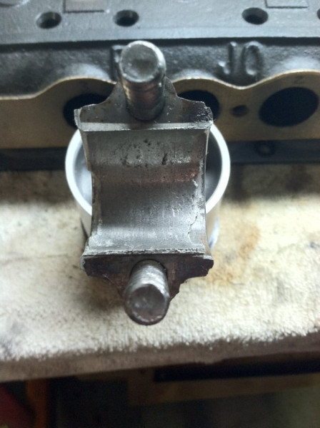

Some very light lines, I couldn't catch my fingernail on any of them. Everything felt smooth mostly.

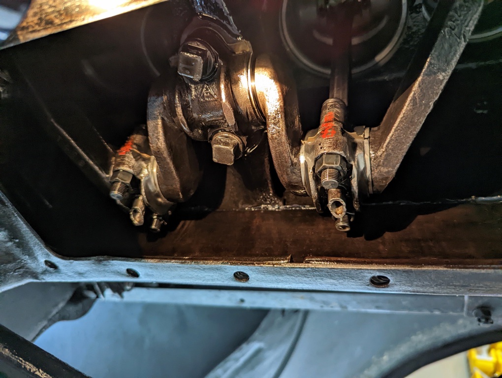

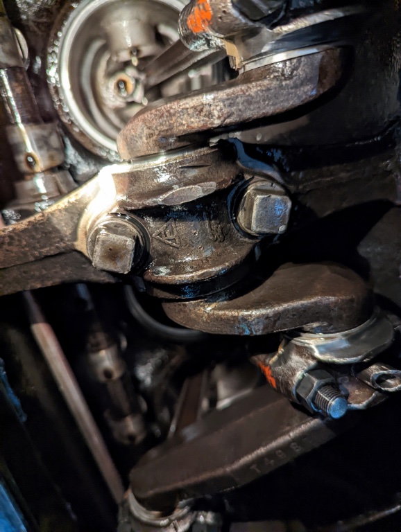

I would drop the pan and check your clearance on all the rods. easy to do and would eliminate of obvious.

My experience with past Z heads is the combustion chambers vary wildly.
When installing such a head, the procedure is to put in place with bolts loose in the block with no head gasket for line up. Bolts allow at least 1/4" rise in the head. Push the head to the left & hand crank. Watch for ony movement. Repeat this test pushing the head to the right, front & rear.
This way you confirm nothing internally will hit. You can install the head gasket.
You can paint the valve pocket/combustion chambers also. Any upset in the paint but no head movement indicates a close situation. Trim tight spots as needed.

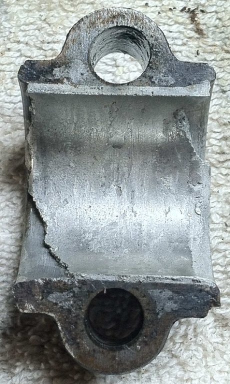

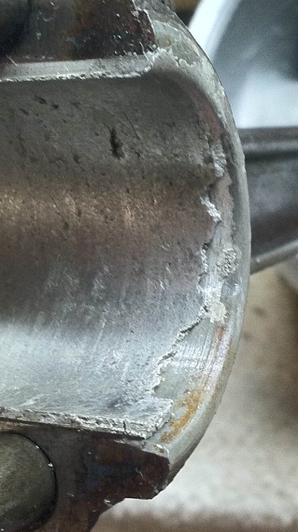

Jason - I had the same knocking sound start on my 1919 after running the engine a few years after a rebuild. Upon inspection, I found babbitt missing on the #4 rod and cap (see photos). Although I have a three-dip pan, after removing the head, I was able to make repairs through the inspection plate. It was a tight squeeze and I had to get a little creative even with small hands, but it can be done. Been runnning well ever since.
Here are links to videos I made at the time:
https://www.youtube.com/watch?v=wHk0fWPFw0w&t=32s
https://www.youtube.com/watch?v=Af_oPY3Ag-Q
https://www.youtube.com/watch?v=ilWMhwHovoA&t=6s
