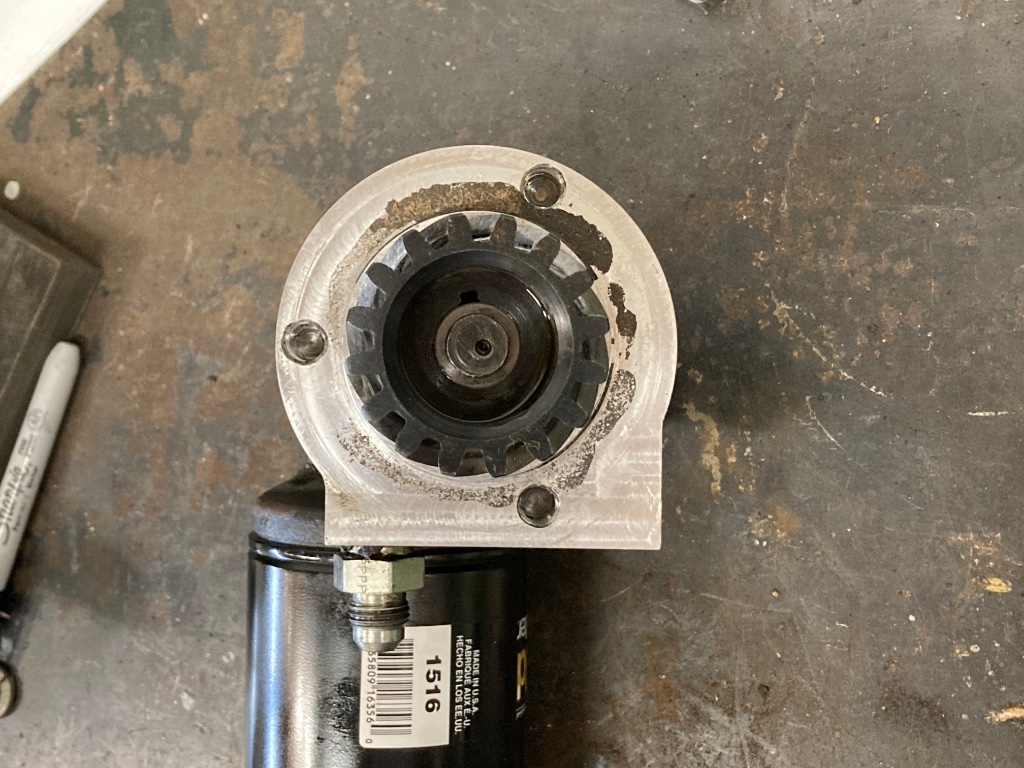

by Kevin Pharis
Here a quick look at what I made all those years ago…
Rough material dimension is 3.5” x 3.5” x 2.0”. Could probably take an inch off the length as the “snout” isn’t necessary. When I made this, I wanted to add a ball bearing to take the radial gear load but never did. After all these years the pump is in good shape, so bearing not needed. A simple register into the generator bracket will do

If someone is going to do this, I'm machining generator gear blanks as I type this and could make some with a .490" bore to fit the Datsun pump shaft.

Dan, I'll take one. It will keep me from having to put a brass bushing in a T generator gear.
