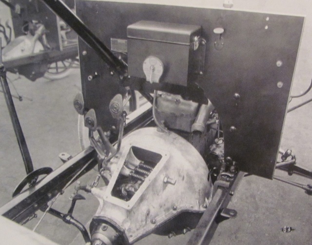

Photographic records c.1914 show the engine iron block being given a black 'wash', M-142, thin coating, (the cylinder head appears already painted at the time of the block painting in this photo), the steel crankcase appears grey without the black wash. The alum. hogshead is as cast.

Early engine installed, note the alum. hogshead.
