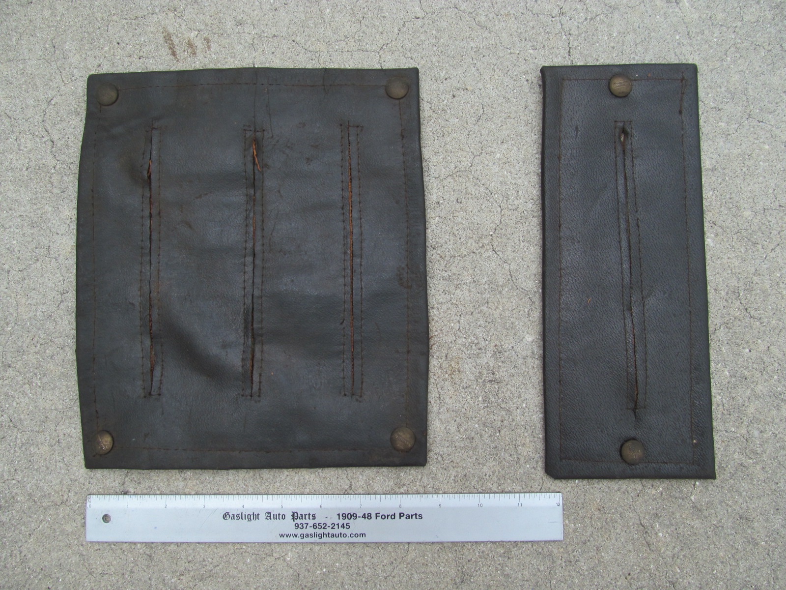

Have this set of old aftermarket, 'Crawford' brand, pedal slip covers, these fit over the pedals and have a slit for the pedal shaft to help seal the area of the floorboard slots. The material is old, the burlap backing is flaking, but top side is still supple. And these have button fasteners on the backside, these are ANZO type, so you would need to find the proper male stud with wood screw mount to fit to the floorboard. PM if interested.
Since the old ones fasten this way, seems you could buy new and use snap fasteners to secure the pedal boots.

Would think the boots should be somewhat removable, as removing the floorboards for maintenance would be difficult. Perhaps snap fasteners on the edges.
Here are some old styles of pedal slot covers, the heavy rubber one is for the '26'-27 floorboard on the hand lever. It has tiny holes for nailing in place as it replaces the std. Ford plate.
