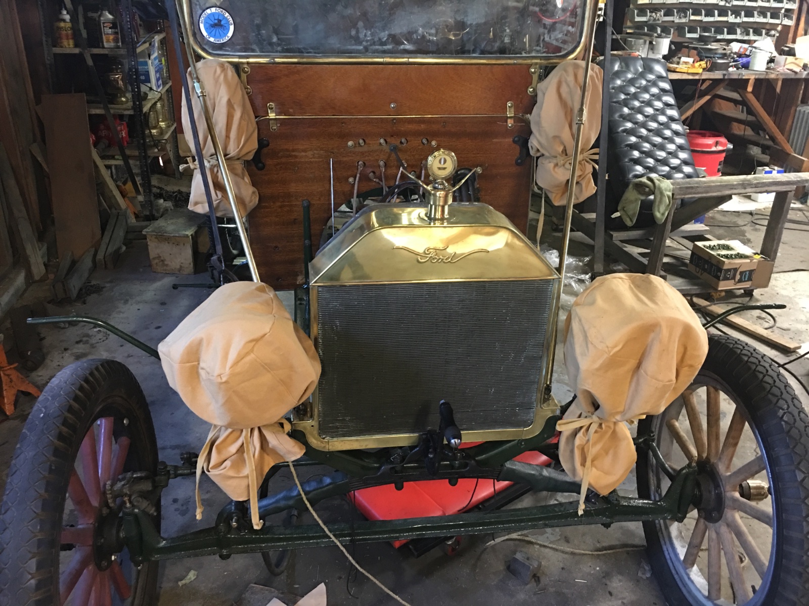

My daughter Carolyn has been getting in on the act and made a set of lamp bags. They came out great with ties so they will stay on and be fairly effective at reducing air flow.
- Lamp covers

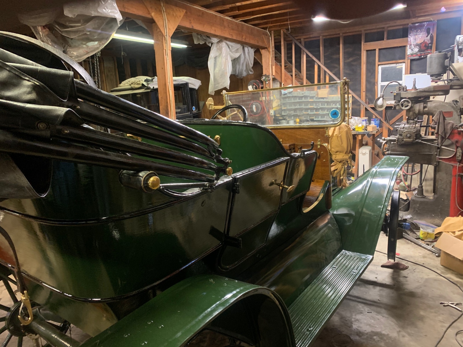

I have the original top back on, it’s shrunk a little so it requires stretching to make it more level at the front
- Top on the 1909

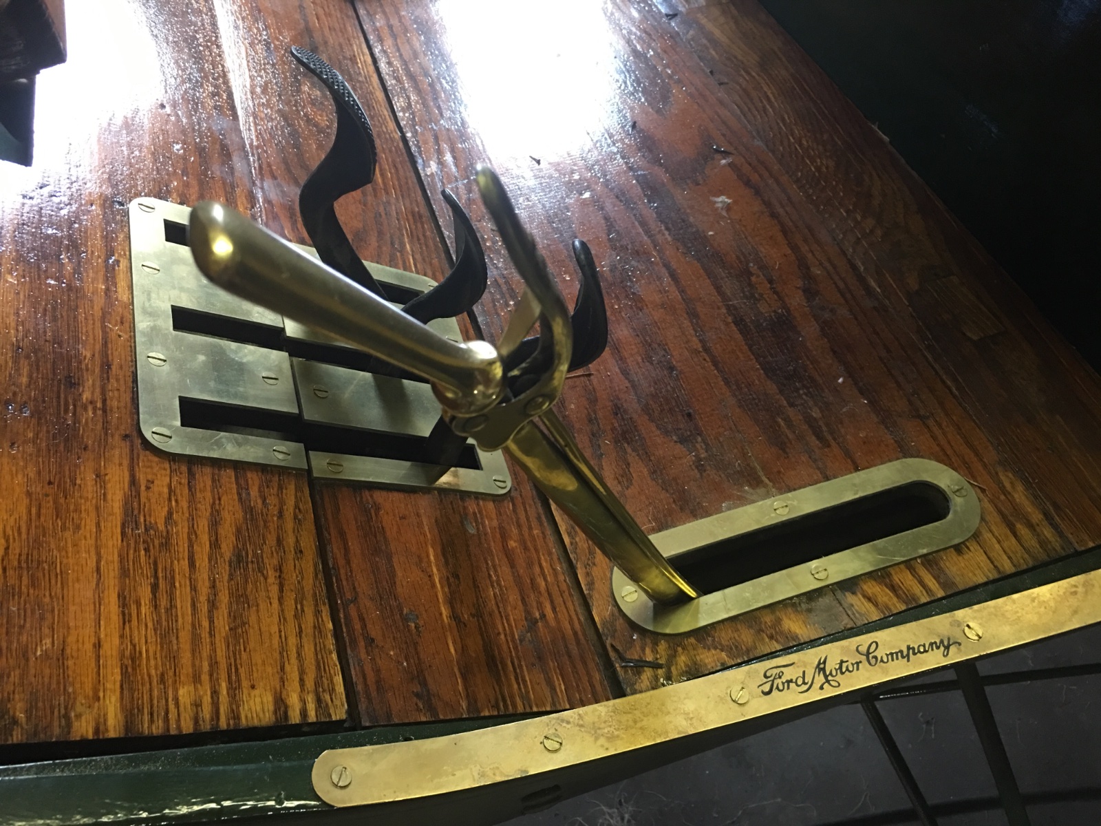

Finally before I leave on yet another trip I have the parking brake installed and the floorboards in.
- Interior of 1909

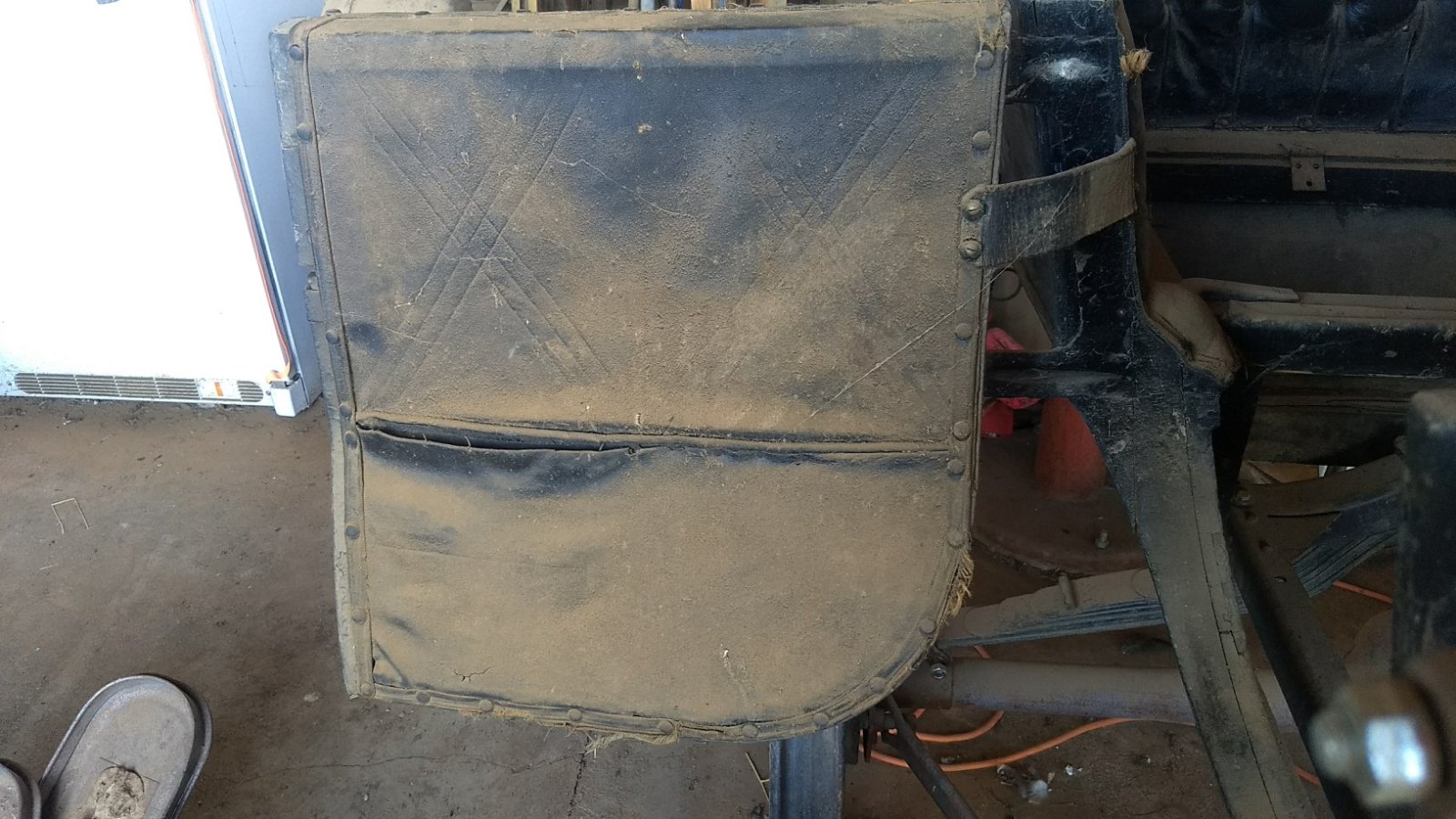

When I get back I will remove the top and have a go at re-installing the original upholstery. Wish me luck.

I had another pleasant surprise when I returned from England. My daughter has made bags for all five brass lamps and a radiator cover.
- Radiator cover

Eagle eyed viewers might notice that the rear seat bottom doesn’t sit correctly, yet another job for the “to be done” TBD list, not sure quite why it doesn’t sit correctly.
Other tasks on the TBD list are the E brake lever doesn’t latch and the reverse needs adjustment.
- E brake lever
- Reverse adjustment nut
How does one get a wrench to adjust the 11/16” nut into that tiny gap? My guess is a ring wrench ground down to a minimum might work.

Hi Tony, I've posted a photo of my Door on my 09 body. I'm not sure if all 1909 upholstery was the same, but mine has an x pattern on the top panel. It doesn't have any backing on the top or bottom, they just nailed the leather right to the wood. The top and bottom were sewn together with round cording in between. It would be easy to ad the x embossing with a strait edge and a small leather tool. It looks like that's how it was done originally. If you decide to go that route, I can give you the dimensions.
Hope this helps,
Michael Paul
Re: Resurrection of a 1909 Model T
Posted: Sun Oct 13, 2019 3:19 pm
by Wayne Sheldon
Such a fine job you are doing with this car! I love to see your updates.
I use whatever scissors I want to. But,I treat all scissors better than either my wife or my mother ever did. I have maybe ten pair, and strict personal rules for what each pair is used for! Some do the dirty work. The cooking pair only touch food or clean food packages. The other "kitchen" pair is used only for basically good, but not necessarily clean work inside the house. The "sewing" pair only sewing needs in the house. There are two "nice" pair that I saved from being thrown out in the garage for "garage or outside" good work. A nice old name brand black handled pair out in the shop that do only "good" shop projects, a similar looking cheap Chinese pair in the shop for "bad" shop work. A couple small decent pair in the shop for general cutting of strings and tape.
Scissors are tools,and tools should be treated with care and respect.
Thank you Tony B for the updates! I enjoy following along.
Posted: Sun Oct 13, 2019 6:00 pm
by Michael Paul
Hi Tony, I hope my info on the door panel wasn't taken the wrong way. you're doing a beautiful job on the restoration. Just trying to help out.
I do need to correct what I said earlier, after closer inspection, the upper and lower panel are not sewn together. What they did was nail the upper leather piece on first, then with plain tacks, it was tacked 1" apart to the horizontal piece of wood in the door. Next they took a strip of leather and wrapped it around a piece of cording. Next with the flap pointing down , it was tacked on to cover the plain tacks used to secure the upper piece. Finally with the lower piece , it was tacked from the inside just below the cording, then folded down and finished with round head tacks.
The photo shows the lower piece how it was tacked from the inside. I was surprised to see they didn't have any backing strip, just plain tacks then folded it down.
Again, just trying to help.
Thanks Mike
Posted: Mon Oct 14, 2019 12:23 am
by TonyB
No offense taken. I have seen several 1909 Model Ts over the years but I only have a couple of pictures of the door leather and only one has the light such that the cross pattern is visible.
- Cross pattern on door leather
When I first took the picture I couldn’t see the pattern but my eagle eyed friend John Pepe spotted it. Even this picture is not too clear, you may have to click on it to download the full size and then zoom in
Incidentally I had not realized it was made up of two separate pieces, mine is one piece with a length of plain trim across the middle. I had to rework the middle support a little as the wood was not at the same level as the outside of the door. This caused the cardboard to wrinkle, so I built the cross wood up a little with strips of veneer.
I wonder why they used two pieces?

I have done some more work over the past month, I now have the fenders back on the car and wheels painted.
- Left side of 1909 in the workshop
There was a monument of confusion as there are four holes in the wood hood former under the hood. On the drivers side I put the bolts in the outer two holes and the clips in the inner two holes. However when I did the passenger side I had the correct long bolts and the holes in the lower chassis member were under the inner holes. From this I checked the lower holes and sure enough the bolts should be in the inner position. Odd really as the hood has wear markings in both position.
- Passenger side of 1909 in workshop
Next is finally fixing the top, polish the hood clips and then I’ll start installing the tires.
