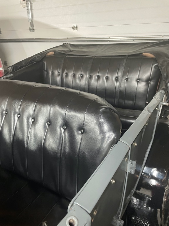

by DanTreace
Robert, true, you want the proper gap. Have always done the seat cushion first and test fit some with the loose backrest cover.
In my install the spring may have been a tad high on the corners, the original photo shows what you should try for.
This is the current look, after a lot of seating! Others do much better at the corner to get a smooth fit, but the big wrinkle was ok for my work ;)
