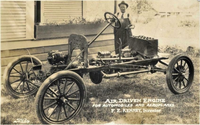

Posted: Sat May 11, 2019 4:39 pm
by Herb Iffrig
I wonder how that worked.
Would it have been vanes like in an air drill or impact wrench?
Re: Old Photo-Air driven car
Posted: Sun May 12, 2019 11:21 am
by George Andreasen
I studied the chassis and frankly, I'm not sure what I'm looking at.......
I see a massive storage battery at the rear. I see what appears to be an electric motor at the front. I see what looks like two inline compressors between the frame rails and some other mysterious device on the opposite side.
Going by that, it seems a battery/electric motor operates two compressors which provide air for whatever type of "motor" this guy has designed. Or maybe the compressors are actually the motors? No sign of an air storage tank that I can see.
Holy cripes Batman! Why not just use the battery and motor to run the thing and skip everything else? Looks like another case of an inventor with a idea that's cumbersome and over complicated.
Posted: Mon May 13, 2019 2:53 pm
by Novice
Looks like a A/C electric motor up front with a starting capacitor ? mounted on the right side. There does appear to be a air storage tank in front of the rear axle. and perhaps air control valves behind the electric motor. Looks like they used the electric motor to run compressors to fill storage tank and then reversed the operation and used air compressors as a drive motor. The use of the large battery I don't have a clue. What a contraption ! Rube Goldberg would be proud.

Posted: Tue May 14, 2019 6:21 am
by jaxenro
"A working model of an air-driven hydraulic motor, involving a new principle in automobile reconstruction, had been perfected by F.E. Kenney, Portland, Oregon, mechanical engineer. The machine is operated in much the same way as a locomotive or steam engine, except that air pressure instead of steam pressure is utilized as motive force. Power is derived from a small electric motor run by current from a storage battery. The motor operates an air pump which keeps up pressure in the tank. The compressed air, mixed with oil, is admitted to two hydraulic cylinders, where it drives the pistons"
