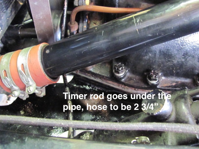

Correctly, goes under. But not the hose, the timer rod should go under the 3939 Outlet Connection Pipe.
Note the lower of the two short hoses needs to be factory length of 2 3/4", some of the repros are cut a tad longer and will interfere with the rod.
The rod should easily clear the pipe, but won't clear a hose, and having it hit or rub the hose won't allow full travel.

The hoses used in conjunction with the tube from the radiator to the inlet as made for a number of years, do not need to be as long as they are in my opinion and can interfere with the rod. They only need to be long enough to have clamping room on either side of the upset on the tube and castings.
