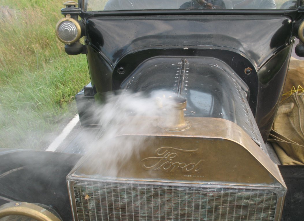

I had a plug come loose on a trip and leak out most of the coolant, but fortunately it didn't fall out and get lost. My box of spare fasteners under the seat now includes a little bag of nickel plugs, and my tools include a hammer and a drift long enough to reach the plugs. I found old time Permatex #2 unsuitable in that application, but Ultra Black has been OK.
A couple of years ago, due to a radiator leak, I had overheating that caused the car to die in the road. It doesn't seem to have done any permanent damage. I expect your engine is unhurt.
