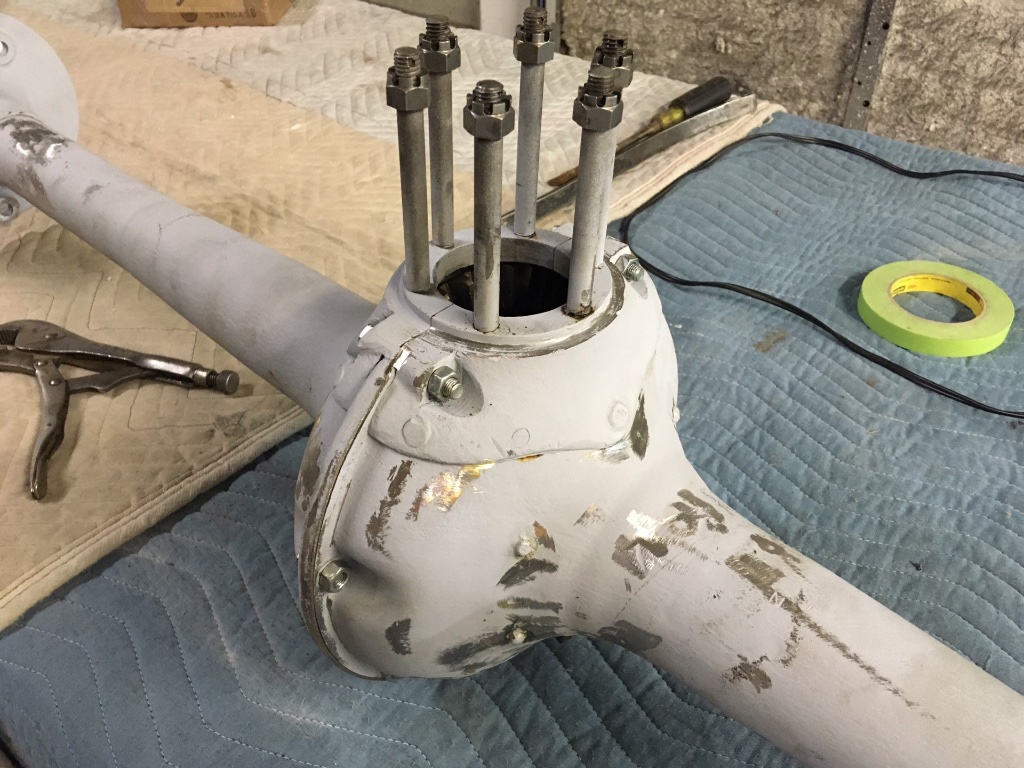

Picking up where I left off a year ago. Everything is where I left it when I departed. Only difference is it is 105+ degrees. Too hot to paint so I’ll take a little more off the new bronze thrust washers cause it’s still a little too tight. Put new brake cams in the backing plates and assemble the rear axle and prime it.

So today I separated the half’s and dressed down both sides of both bronze thrust washers. It was way to tight when I first set it up, so I knew it needed a fair amount taken off. I do that on a large disk sander holding the washer and rotating about 30% of the face on the sander with my finger tips applying pressure on the washer. The washer gets hot on your finger tips so I lay it on a cold piece of steel and work on the other one till I think they are done. Then I put new brake cams in the halves while they were apart. Cut some pins from a piece I found in scrap, dressed them and peened them. Went to reassemble the axle and noticed I had the guts in backwards. I put the wrong half in the vice and following my usual assembly habits I noticed the other half slid over the first half and not into it. I stood back and sure enough , ring gear on the wrong side. So after doing it right I bolted them together and had just the right drag pushing the ring gear with my thumb. Driveshaft was too tight also, so I knocked the pin out and took a few licks off the U joint. Reassemble and install into axle and now everything rotates smoothly with just the right amount of drag. Tomorrow I’ll work on filling some dents and scares and get it ready for paint.

Yea I’m glad I caught the wrong side ring gear. Then as I sanded and prepped things, something about the d/s tube didn’t look right. It appeared the spool housing was not seated inside the bottom of the d/s tube. I looked at another one I had laying there and the tube bottom has a small flange around the outside edge that the spool seats into. I stuck a razor blade between them and it gave me the sense that I was feeling an edge. Oh, brother, now I had to remove the shaft disassemble and seat the spool which meant installing a new d/s collar bushing to take up the slack. But once apart the d/s tube had no flange on the bottom and was a thicker casting than the 2pc. I was using for comparison. So I reassembled and reinstalled the d/s. Always better to recheck. Especially if you’re 74 and it’s been a year since you set it up. Nothing worse than a rear end coming unwound cause you overlooked something. Filled battle scare’s yesterday and primed today. Now on to engine cosmetics.

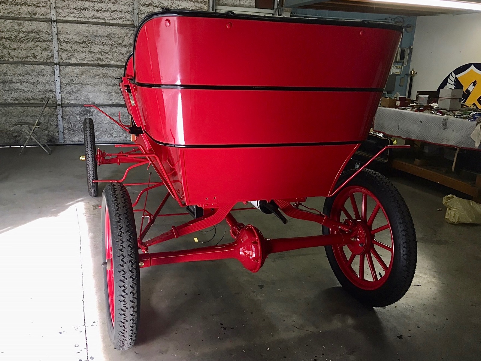

Larry, the shackles are in correctly. First round of paint on rear axle. Nothing is easy. Had to replace all the ceiling lights but one in the booth. Guess I didn’t clean the gun good enough when I left last year. The tip and the fan were frozen to the bottom of the bucket in some kind of amber substance that was hard as nails. After breaking them loose I drilled the air passages with tiny bits and then let sit overnight in paint stripper. Got it to work, got it shot, got a few runs. Now , tomorrow l will sand it out and try being a little more cautious with the second round .

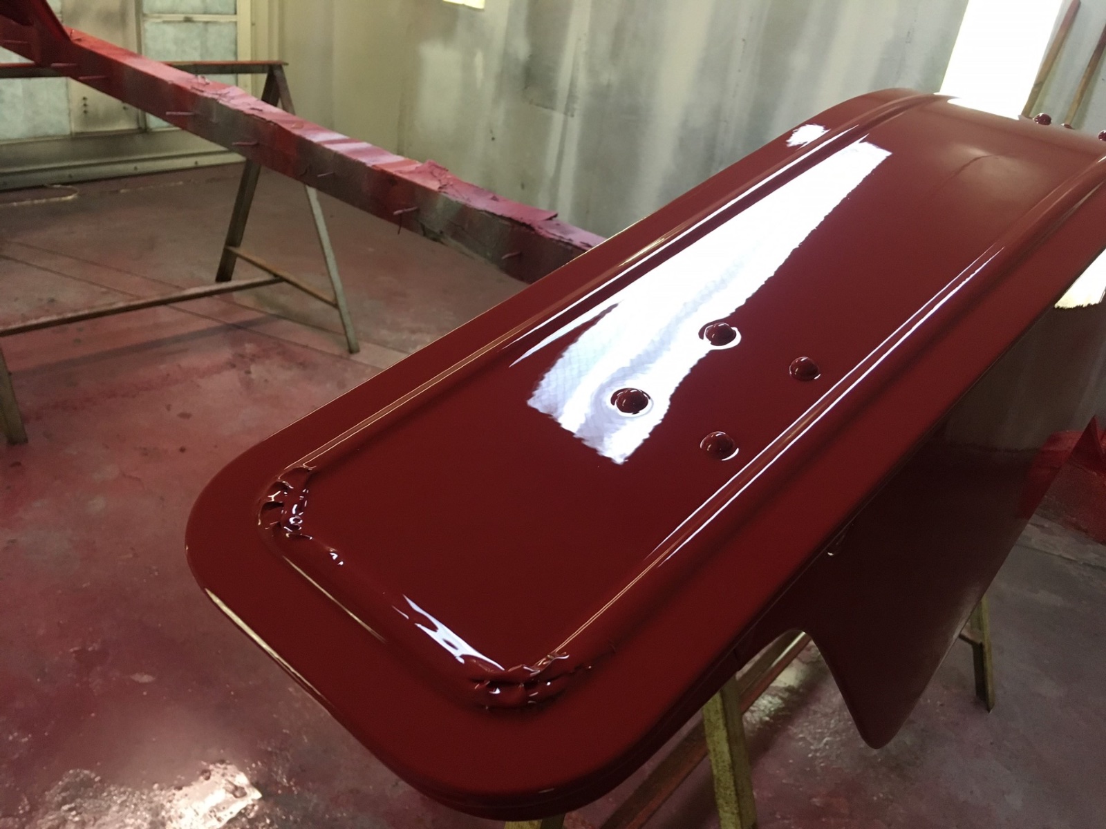

A few runs, a few drips and a few errors. Inside came out nice but got a few sags on the outside corner. Either too close rounding the corner or too much overlap. Will let it dry for a few days and then take a look at it.

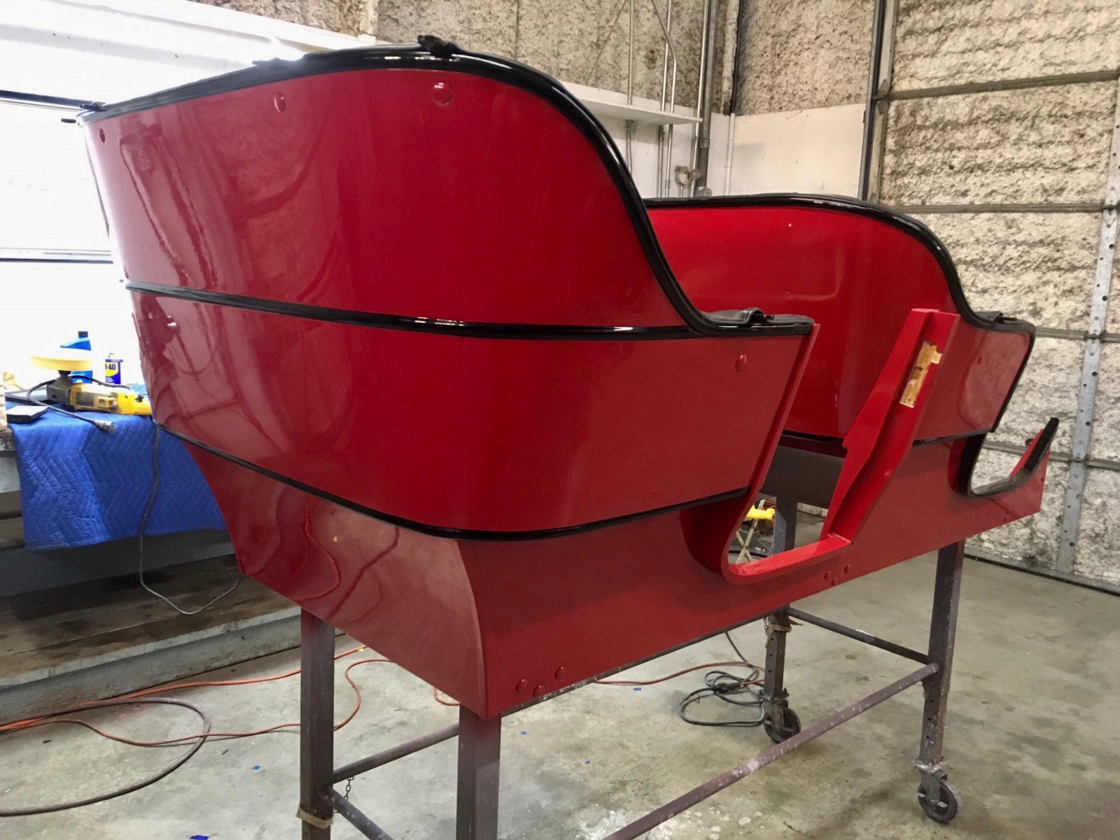

Doctored some screw ups in the paint on the body.Not a show car but plenty good for an assembled car. The upholstery had been masked off since April of last year, with layers of etching primer, fill primer, and multiple color coats. The paper and tape were brittle and fractured rather than tore when removed. No damage to the leather work and remarkably clean. So now I’m ready to brush
paint all the exposed wood with black lacquer to seal it up. Still have final color on the doors, get them fit and I think the body is ready to go back on the frame. Yippee!!!

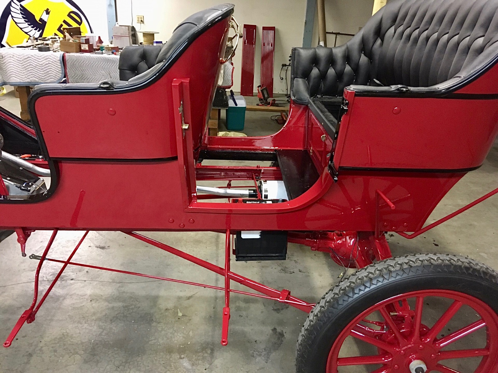

And here’s with the wiring in to run along with futures for the tail and brake lites. I really want to put 12V seal beams in the E&Js but haven’t been able to find the 5” lites with a steel ring that you can bend outward to fasten them to a flange you solder into the light. They fit in the back of the light and give you high and low beam. They look like this.
Also got front floor, engine block plate and floor mat fit. Seems to be moving along good now.

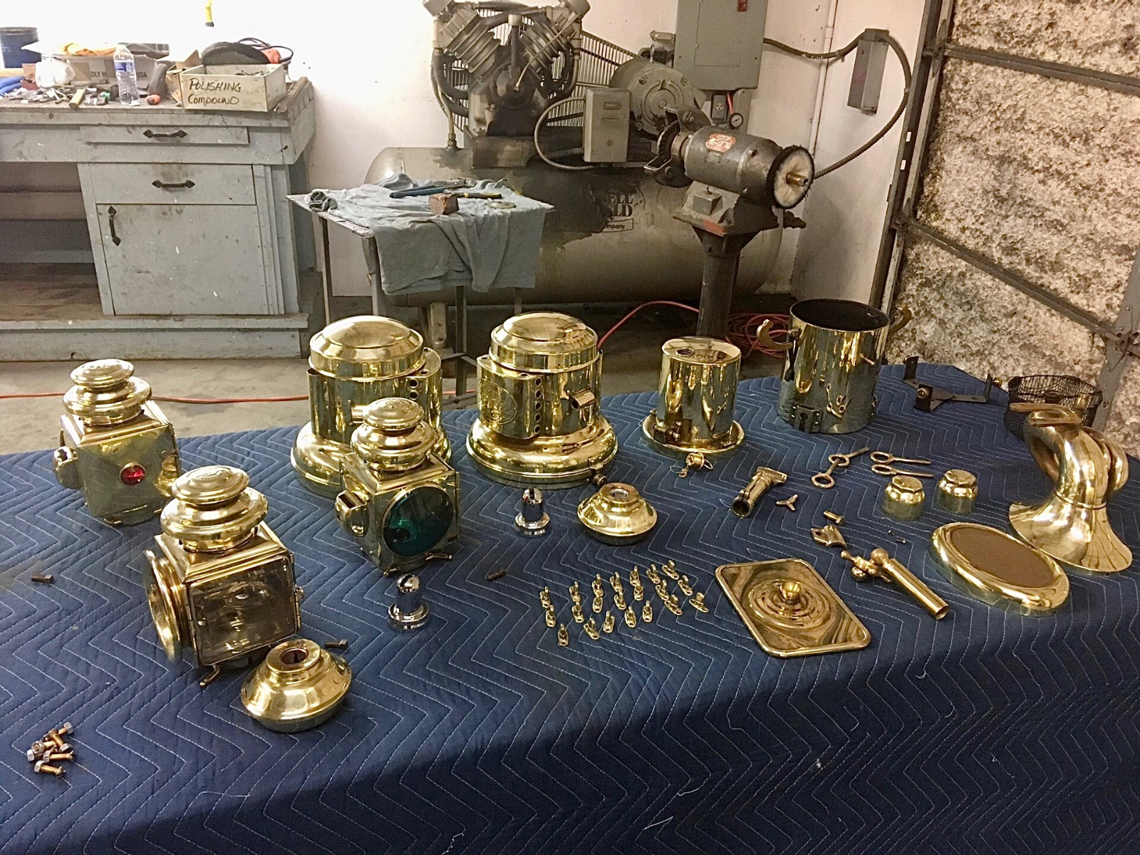

Spent yesterday buffing and polishing 25 yrs of tarnish. I thought my back would break and my hands would never come clean again.

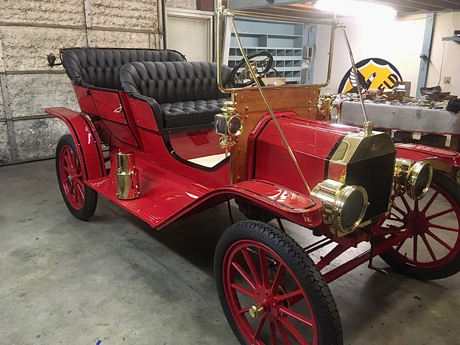

We are down to lots of little things to get this ready to go in the trailer this week and head home. Been a lot of work, but I like how it is turning out. Not a show car, just a clean driver that you don’t have to worry about. I’ll finish it in Ohio this winter. Hope you have enjoyed the process.
