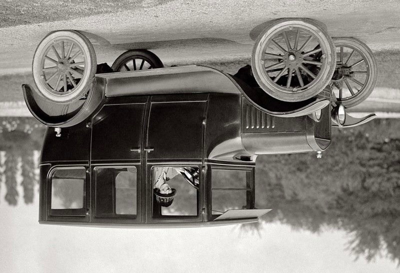

George House wrote:
Tue Sep 19, 2023 9:42 am
Wayne, better be specific and identify ‘left side’ or Allan from down under will jump onto you like a bird on a junebug. He drives on the right side 😜😜
Actually left and right are the same down under as here...they just drive upside down! :lol:
Re: Front License Plat Mounting
Posted: Fri Sep 22, 2023 4:32 pm
by Norman Kling
Now you are being silly. Everyone knows the earth spins on the axis which is straight across and whether right side up or upside down only lasts about a second. It takes 24 hours to turn all the way over :lol: :lol: :lol:
