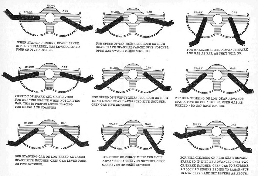

Here is an oil level chart and a diagram that will help you with the general positions of the control levers in order to attain certain speeds and conditions.
