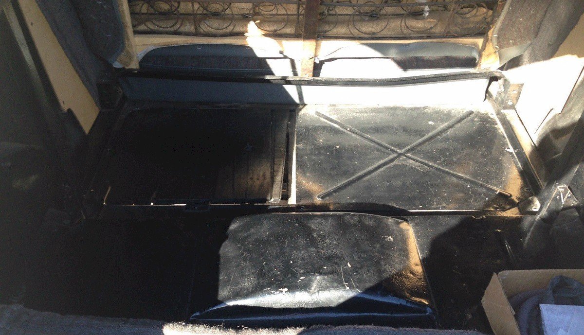

Re: 26 trunk floor install
Posted: Thu Aug 10, 2023 6:00 pm
by varmint
John,
Here are some trunk area photos (don't remember the source):
trunk 786180.jpg (28.51 KiB) Viewed 1898 times
trunk 786181.jpg (31.47 KiB) Viewed 1898 times
trunk 786182.jpg (26.18 KiB) Viewed 1898 times
