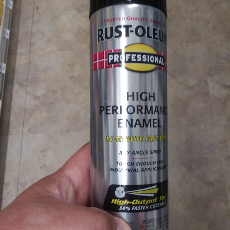

by Professor Fate
I used this on frame and body with great success. Best rattle can paint system I've ever used.

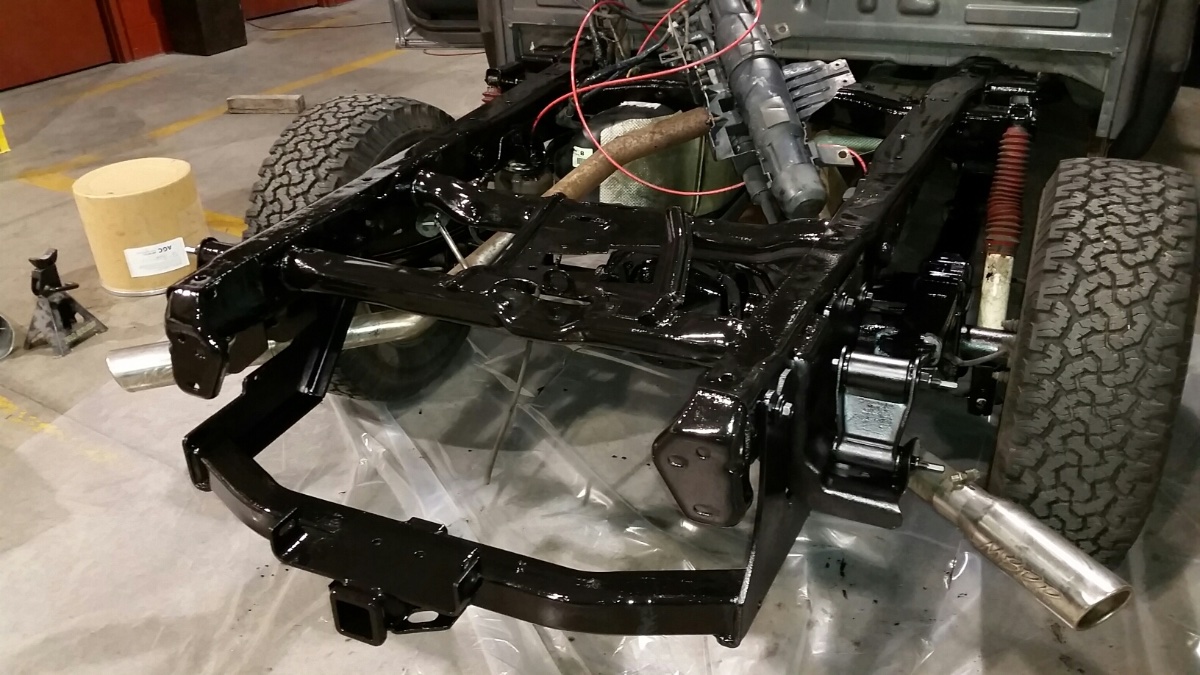

Posted: Tue Jul 18, 2023 8:38 pm
by Billy Vrana
If theres original paint get a foam brush and find some penetrol, it'll reseal and rejuvenate the paint for quite a while,
