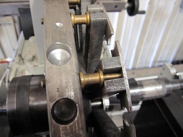

Seeing the orginal commentor's post reminds me of a 1914 engine we rebuilt which I'm sure had been rebuilt numerous times prior to landing here.
Flywheel was so far off, I had to do some heavy metal removal to make it balance.
This particular flywheel assembly was off a total of 1000 grams. Which left unchecked would of done some damage.
If you'll notice two drilled holes removing weight which I've balanced flywheel assembly to tenth of a gram. Making it a smooth running engine.
