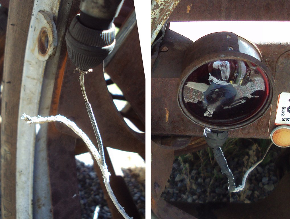

I felt good enough to do some work in the shop after my 2-week health break. The spare tire on the Coupe had lost air so I put on a good one. I left my reflector bar off as it makes changing tires more time consuming. These Riversides I got from Rich B. in the '60s are great spares. I wouldn't buy whitewalls, but his all-white paint job looks great these days.
I noticed my taillight needed refreshing. The plastic window disintegrated, and the white cardboard reflector warped out of shape. I think these were standard and they do make the taillight brighter. I also resoldered the socket as it was loose. I made sure there was a good ground to the spare bracket.
The wire insulation was frayed so I refreshed it with "friction tape".
The light didn't come on so I will check the bulb and connections soon. It was nice to be doing some work again.

I got the taillight to work. The plugs have been exposed to the outdoors, Summer and Winter for 10 years now. They fit tighter into the sockets and have some corrosion and dust in them. I think these are old originals. I wiped with lacquer thinner and scuffed with Scotch pads and they fit better now. The headlight plugs needed it too and work fine now. Grounding is also a problem with outdoor cars.
My cars that sit outdoors show me many things that are problems and some that really are not, that I wouldn't know about with the pampered indoor cars. This gives me better insight into what owners contended with back in the day. I thoroughly enjoy that. Something many don't get to know.

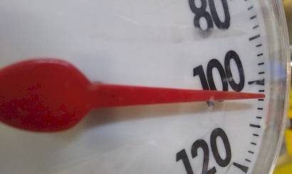

What I did on my Model T today ?.. Well, I walked out to the shop, saw 108* on the thermometer, and walked back into the AC house 😎

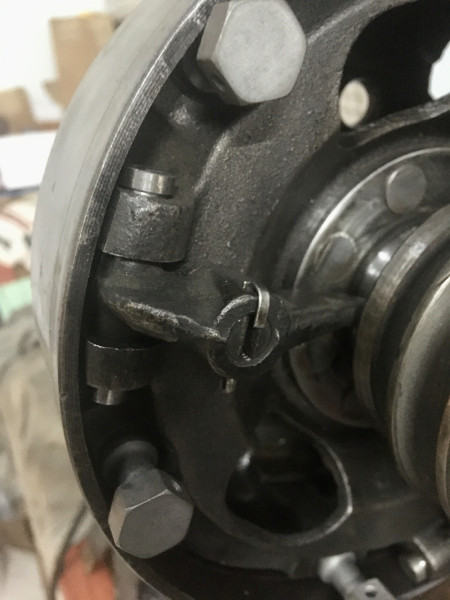

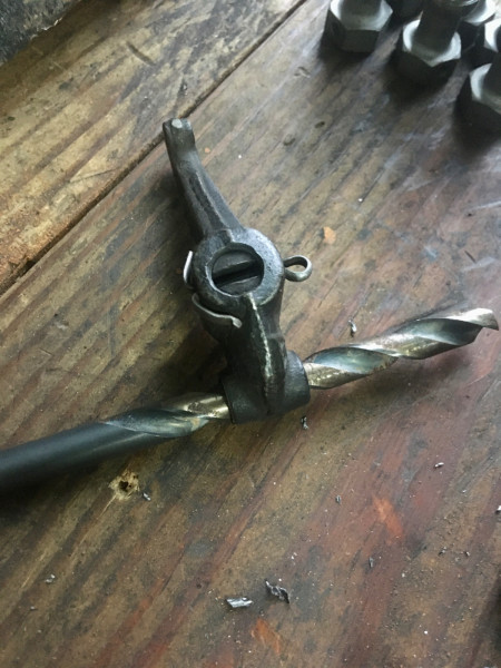

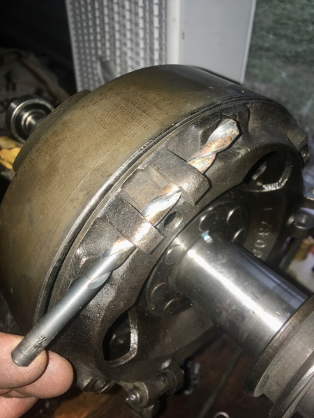

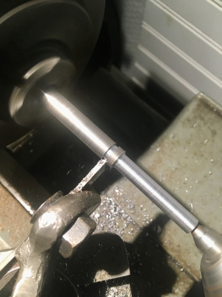

Turned some drive plate pins
the originals where to sloppy for my liking
19/64ths did the trick
Just enough to get everything the same size
A nice tight fit with enough clearance for oil
I will finalize later when I buck them tight

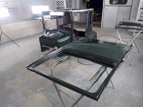

Got to painting the black parts.
It's a 100 footer.
I looked for steel replacement fenders and never found any. So, we patched up what we had.

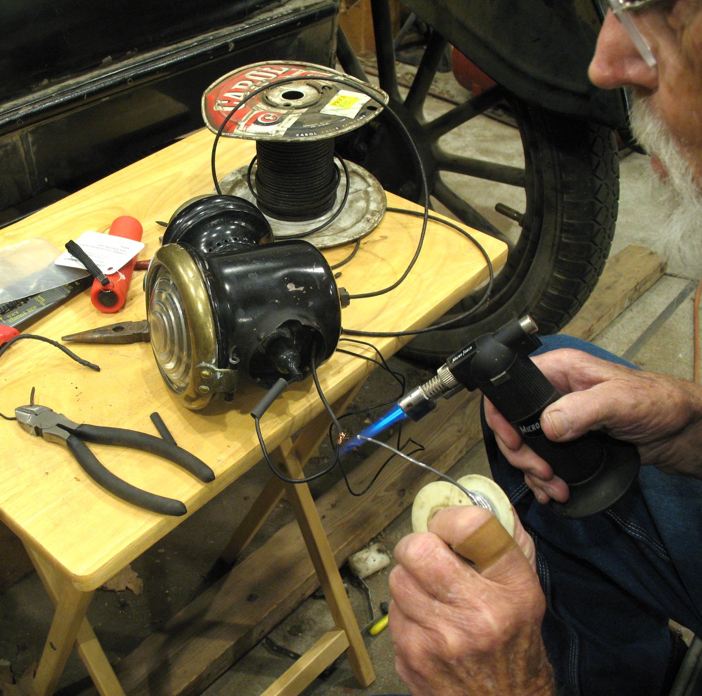

A few months ago, half my turn signals quit working. The left turn side worked normally, but flipping the switch to the right got a faint flicker from the indicator. I assumed something had gone haywire in the control panel, so I took it out of the car to investigate. With all the outgoing wires disconnected I found that the control panel worked normally.
It didn't take long to find the broken insulation that was grounding out the right side. The arrow points to where some bare wire was showing and had been grounding the circuit.
Part of the reason for the cut insulation was that the wire going into the lamp was very tight in the hole, and pulling it in had made the cut. Originally I had drilled a ⁷⁄₆₄" hole, so I enlarged it to ⁵⁄₃₂". That allowed a new wire to slide in easily. Since learning about the mini-torch here on the forum, I've found it better than a soldering gun on a lot of jobs
The green lights are turn signal indicators. Both of them are flashing together, along with the red light, to indicate that the emergency lights are on. The blue light reminds me that the tail lights are on. Opposite that, to the left, is another blue indicator that isn't lit because it comes on when you step on the brake pedal. All these lights look washed out in a photo, especially the red, but in real life they are really red, blue, and green.
