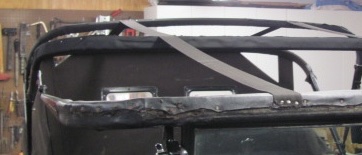

Surprise! See the pictures below I found the old rear seat body mounts still in place with the tops cut off. These T's are fun to work on when you find weird things like that. No such luck with the front seat ones. Where do I place the front seat ones? There are no marks. I assume it is carriage bolts for the bottom of the front seat mounts through the steel and the wood?
Re: 1922-23 two man top.
Posted: Sat May 18, 2019 2:29 am
by VowellArt
It actually kind of self locates, the bottom of the front top iron, has two holes in it and slants it forward at about 15º. These two holes mount to the seat box frame, bolt them up there first it will place the irons where it is supposed to go, then you'll know where to fasten it to the seat back tack rail.
See the holes at the bottom of the front Irons?
This is where they attach, these aren't attached correctly either, had to tell this guy at the Bakersfield Swap Meet about the mistake in their location, so he could correct it. He said he wasn't going to bother because the armrest is already notched for the top part of the iron. I told him I made the same mistake and patched the notch, once the padding is on and the covers, nobody is going to know you patched it, but you may notice some problems keeping this way instead of changing it, because they did it for some reason. He agreed and changed it.
Also only the 22 has a 2 man top, even though the body is a 23, latter in 22, they went to the 1 man top, which continued through 25, 26 and 27 were slightly different in that they truly were a 1 man top. ;)

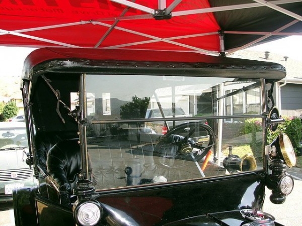

One thing I recommend is to get a copy of Vince Inccino's video on installing a 2 man top. He was a retired NYC fireman that retired and was making tops. He passed away, but his video's are still around and probably somebody has a copy of it. Anyhoo, the reason is because he shows a way to take the top deck (at the front, because that's where you finish installing your top), after your tack the front of the deck to the front bow (and just have the excess bulging corner fabric) cutting it along the corner of the bow about 2/3rds the way and then pulling that material forward and up around the corner to where the end of the windbreaker is, then tacking it to the corner (with the little slits to make it lay flat). It helps protect the corner of the bow from the weather. Sadly I didn't do that because I forgot to, oh well. :?
This is how the windbreak is supposed to fit against the windshield, notice how you stretch it across the corners of the front bow...this makes the fabric fold back against the windshield, but it doesn't even roll down over the windshield as I think Classtique says it should, but then my top is a Cartouche kit. And if I could have remembered to do that fold over with the excess corner material (you cut it back to about just past the corner bend, then wrap it forward around the corner) it would've totally encased the front bow and looked much nicer too. ;)
