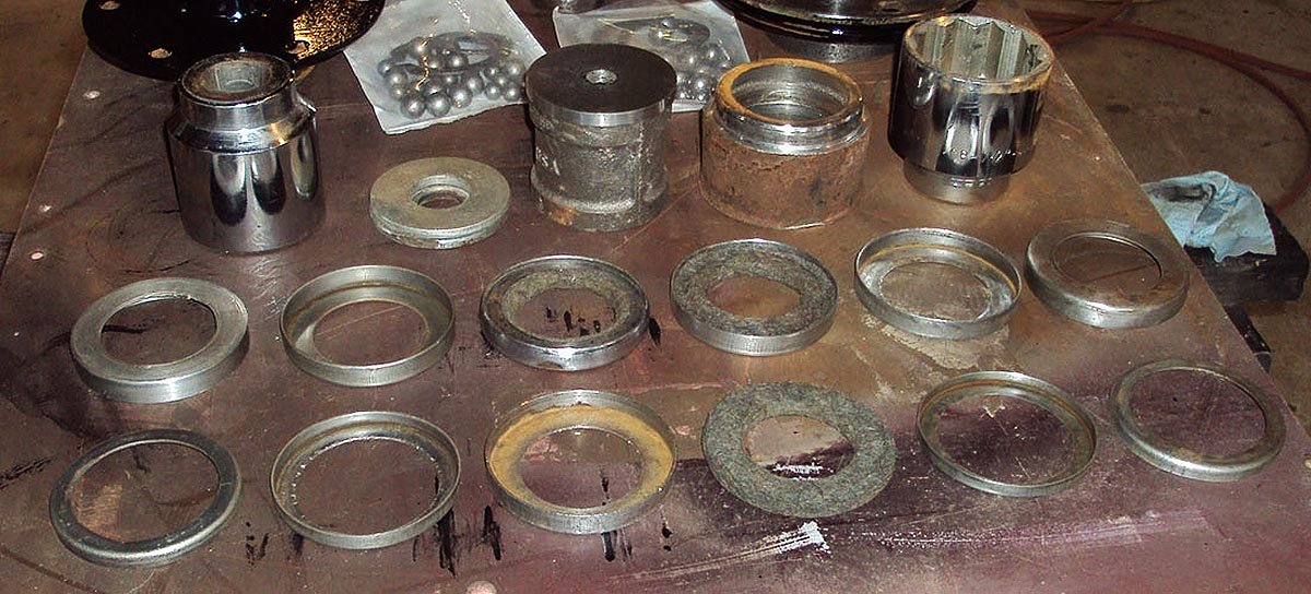

I tried searching on the Forum but have not found an answer to this question. I would like to restore the original Pruden front wheel felt grease seals on our T. I've looked a little for the felt but am not sure of the density of felt to purchase. I think it would be in the F3 or F5 range. The timing gear cover on our '14 engine also has provisions for a felt seal where the camshaft come through the timing gear cover. It is unlike any timing gear I have seen before. It has a u-shaped recess that had a felt washer in it. The felt washer kind of looks like a flat washer. I'm guessing Ford used the same density of felt as they did on the wheel bearing, but not sure. Grainger (as well as other places) have nice descriptions of the different types of felt. Any thoughts? Any ideas how to cut a ring of felt out of a sheet?

McMaster-Carr Supply might well be better source of felt material than Grainger. Can you post some pictures of what you need this felt for?

The plain felts for the front hub seals are available from all the parts suppliers. Same as the one that goes in the rear hub.

I had great fun reshaping the housings for those seals. I used rear axle felt and cut it thinner for them.
