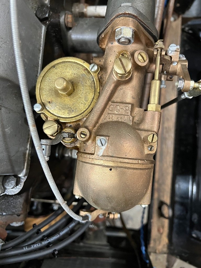

I have a Stromberg OC-2 carb on a Frontenac head.
I have a 19th edition Dykes but it does not specifically cover the OC-2.
It does cover the OS carb which is pretty close.
Any help would be greatly appreciated.

The hard part is getting the economizer set up. If you look at the page of instructions that was linked, it says factory set with no info given. I asked that question here some years back, but do not remember how I titled the question.

Fortunately, Stan Howe worked over this carb before he passed.
I worked with it today and it came down to a small tweak on the main mixture.
I am discovering that this is a lot of carburetor for a four cylinder Model T. !!
