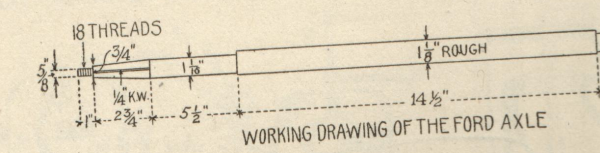

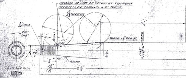

Can someone tell me the taper on the end of an axle?

maybe this helps?

Post by DanTreace » Wed Sep 13, 2023 5:32 pm
SteveD wrote:
Wed Sep 13, 2023 12:38 pm
1 1/2" per foot. Ford axle drawing.
