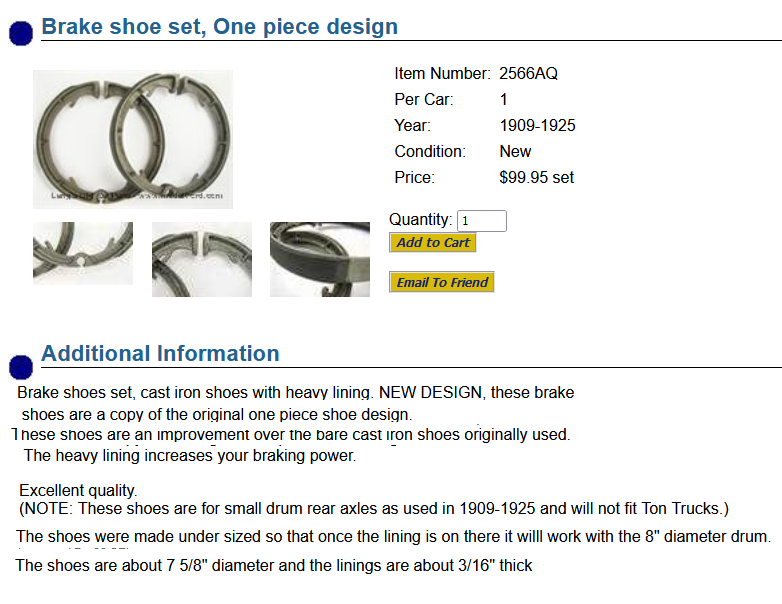

These are ones for people who bought non-original style brake shoes - doesn't say much
brake shoe linings.png (26.84 KiB) Viewed 882 times
May be cheaper in the end

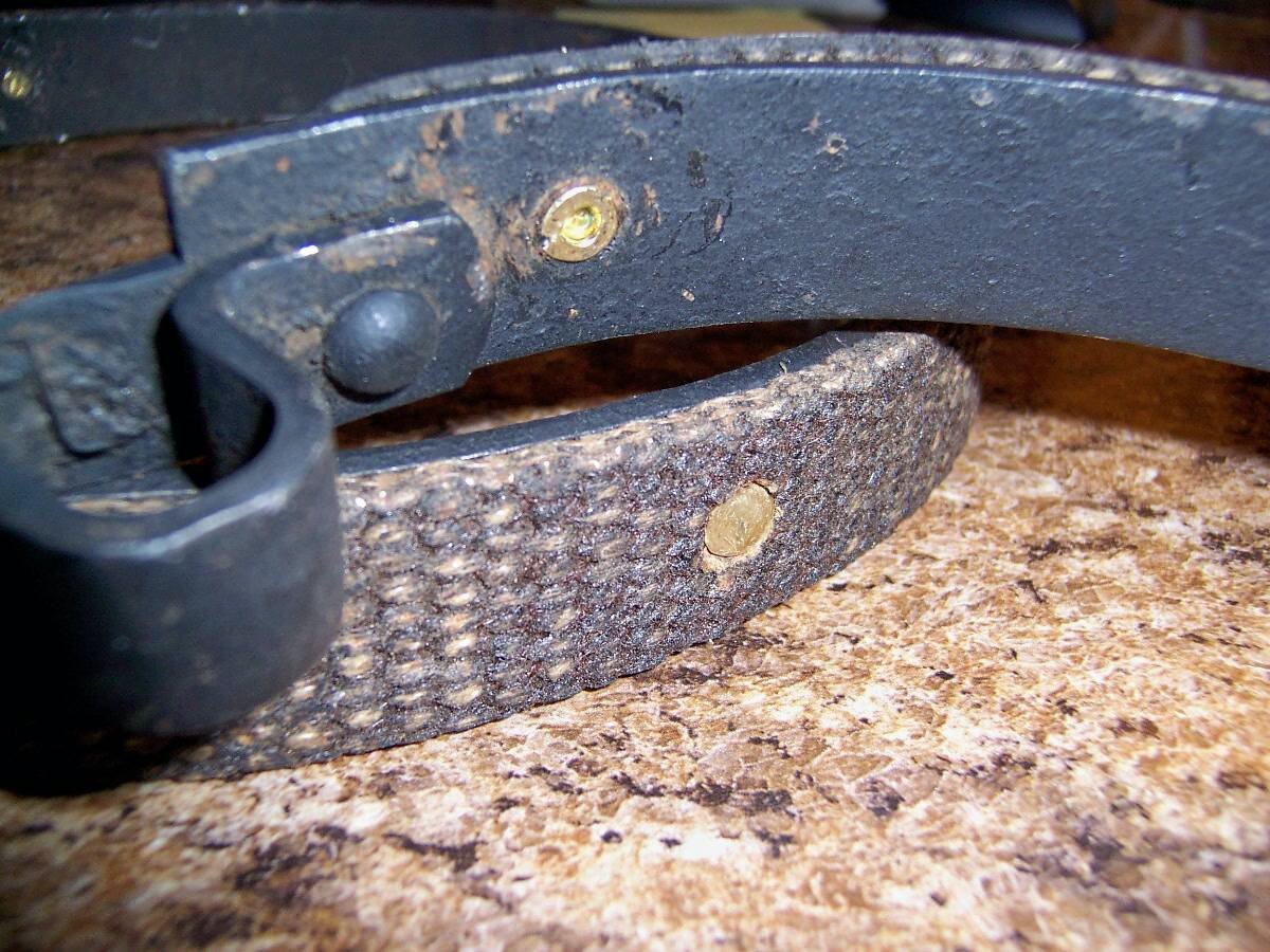

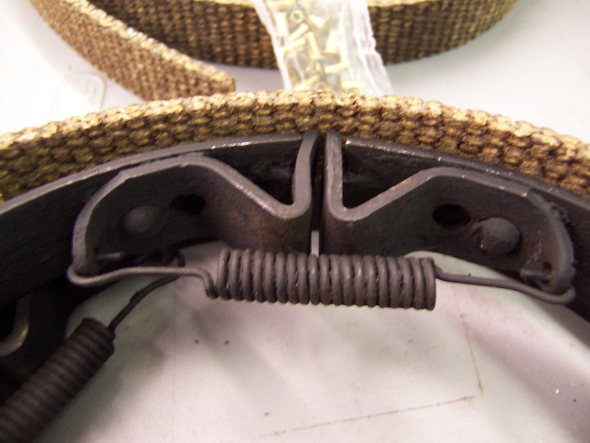

Used the modern lining sold for the 26-27 big rear brake drum. The lining is woven with brass so take care in handling. It's also too wide, but riveted it on one edge and then to the bench grinder removed the overhang. Use care with gloves and good face mask and shield to prevent inhaling dust.
Used hollow brass rivets instead of the supplied split rivets. Countersunk the head and figured the more solid hollow rivets gave best security.
