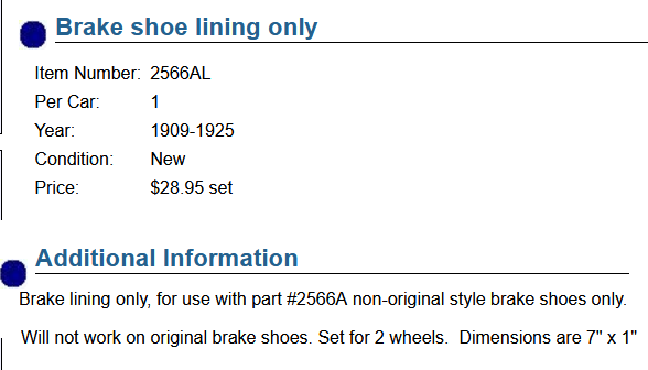

Back in the 60’s I bought a pair of accessory lined brake shoes to replace the cast iron ford ones. I recently purchased a pair of brake shoes like the ones I bought in the 60’s. Where do I fine brake lining for them? They are 1” wide and held on with split rivets.
Thank you in advance for the information. Craig
These are ones for people who bought non-original style brake shoes - doesn't say much
brake shoe linings.png (26.84 KiB) Viewed 842 times
May be cheaper in the end
