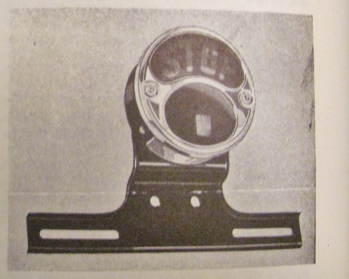

As for brake lamp, you are in luck with the '26, you can add the factory accessory Stop/Tail lamp. And have a nice brake light too. They can be found still today at swaps or eBay.

If not pure, you can at least do it so it looks authentic. The venders sell a right hand tail lamp bracket for your year car. If you look closely , you can see I filled in the license plate lens hole. A little modification to the mounting bracket, and to me it looks like something Henry could have ( should have ) made. These are mounted on my station wagon, so I used fender irons reshaped. My rear M-P fenders were never drilled for lamp mounts. I also hide turn signals, and also use period stuff for this. It’s great fun to search out and restore turn signal sets from the era, and I use small glass lights hidden up in the chassis so less conspicuous, BUT these ford issued accessory tail lamps can be rewired easily for turn signals. Again, just my opinion, but I've scraped my share of victims off the asphalt, and it ain’t a pretty sight!
