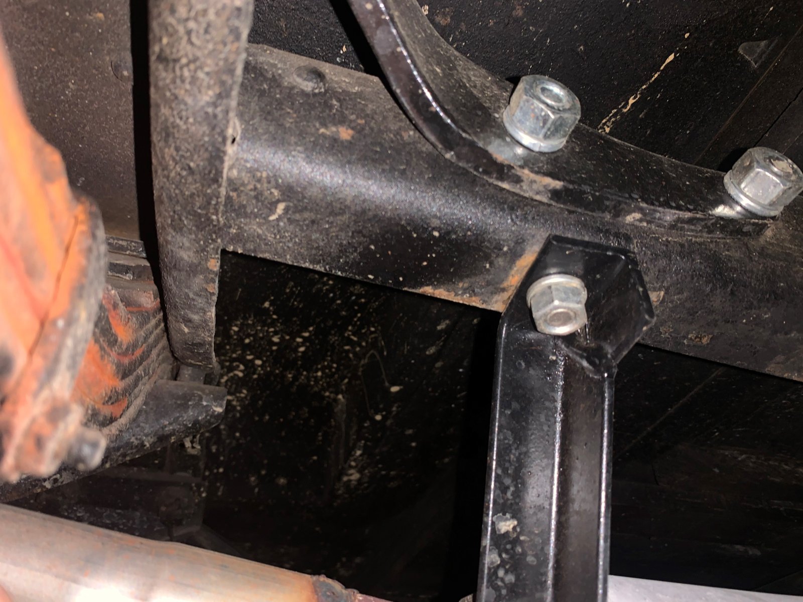

This might be a little hard to make out but I build a bracket from 1" angle iron, bolted it to the frame in the muffler hole and put a U bolt around the pipe.
