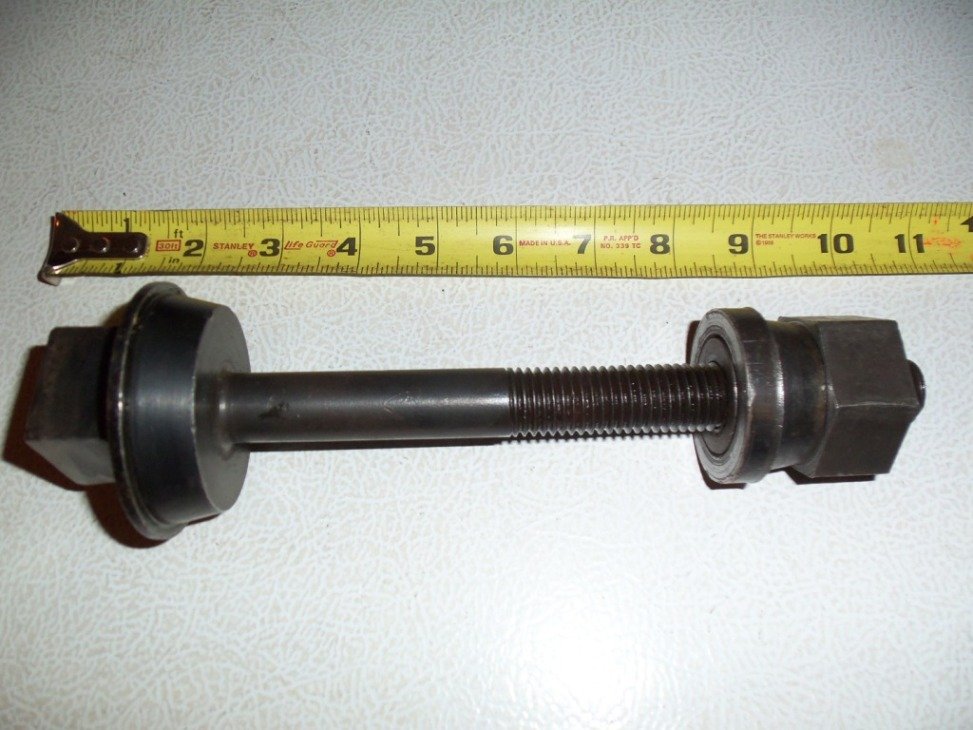

- Posts: 5589
Re: 24' Touring Changing Front Wheel Bearing
Here's what the Ford Service tool looks like for installing new races.
