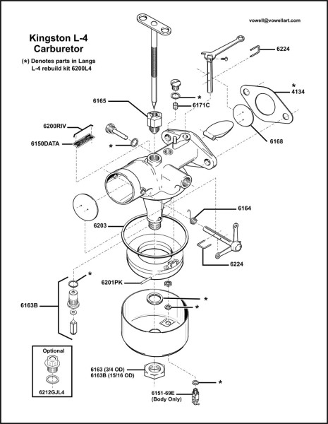

This is the assembly drawing of a brass bodied Kingston L-4.
My Kingston L-4....it's what started me on my project of drawing the whole bloody car, mainly because nobody has ever done it before!
The dimension for the bowl nut differences are; the top one is for the brass body and the bottom one is for the cast iron bodied carbs. The cast iron versions were cheaper to manufacture, but they suffer from the same problem as all cast iron does....it rusts and or corrodes from the condensation that builds up in a carburetor body from the constant warmer (whilst running) and cooling (when parked). All cast iron has problems with this, that's why you paint it...but you can't paint the interior of the carburetor, so once in a while you've got to clean it out, brass carbs, don't suffer from this.
The boxed item is the "Optional" Gross Jet inlet valve, but you can't use this with an under the seat fuel tank, unless you're also running a fuel pump. The under the seat tank doesn't provide enough fuel pressure to effectively make this valve seal off the fuel flow by itself, you need something to provide a constant pressure upon it and a fuel pump works just fine for that.

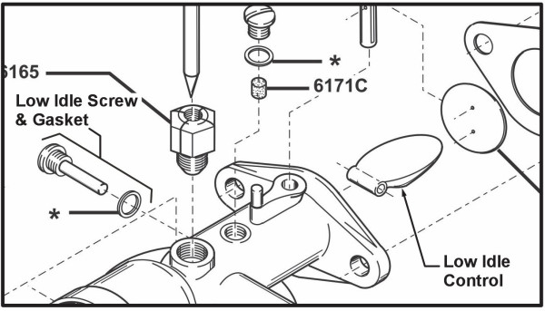

Not sure what you were asking about (maybe I should've watched the vid)...but these parts are absolutely essential for a Kingston L-4 to run worth a damn.
All Kingston's (with the exception of their Vaporizer carburetors), control the air/mixture flow through the carb. with some sort of air pressure/flow obstruction....the early Kingston's did it with balls, the L thru L-4 used various sizes of this flap. Even the Simmons Super Power Carburetor (which is basically a copy of a Holley Straight Thru) uses a small flap on the choke side of the carburetor to regulate the mixture flow through the carburetor at slower speeds (which for a Straight Thru is absolutely necessary to make them perform at slow speeds or idle without having to readjust or run a richer mixture).
As for not getting that screw out. It's usually the paper gasket washer that has fused to both the body and the screw a little WD-40 will also help break it loose. The gasket set from Lang's comes with a new one for this screw as well as a new one for the bumper screw on top of the body.

One other thing, if you've never replaced the cork bumper (6171C), you should. That's what gives you the correct max opening for the low speed flap. it is under that top brass screw on the throttle side.
