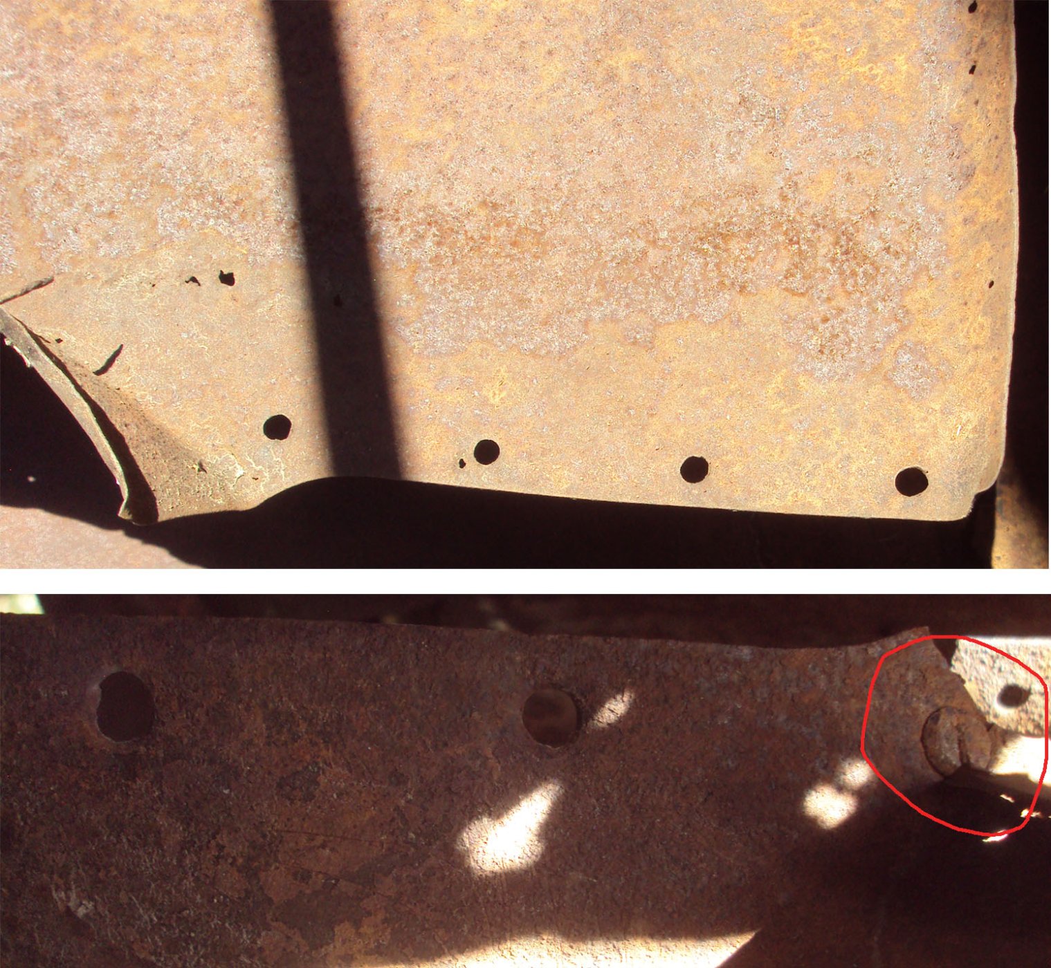

by Rich Eagle
Round, slotted wood screws is all I have ever seen there. I believe the red circle shows one remaining one in this panel. There should be 4 holes in both panels to be joined. They are mostly covered by the rear fender and only part of the top one will show.
