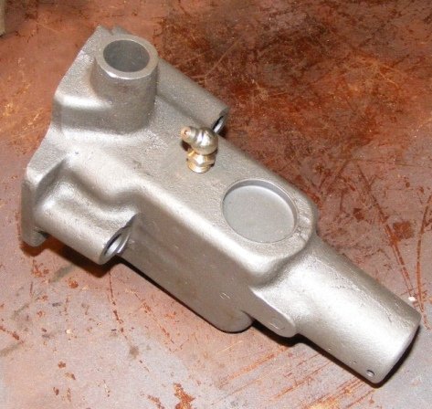

Where does the grease fitting go?
Posts: 2550
Last Name: Strange
Location: Hillsboro, MO
Re: Ruckstell Shifting Problem
Post by CudaMan » Thu Oct 19, 2023 11:02 am
Here, according to Stan Howe. :)

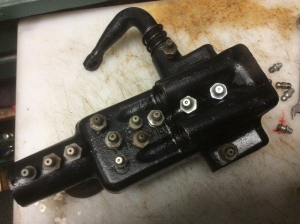

Post by speedytinc » Thu Oct 19, 2023 11:13 am
Cant have enough grease??????
More the better
More the better
rux shifter grease fittings.jpeg (54.14 KiB) Viewed 833 times
:lol: :lol: :lol:
Image ripped off from an earlier post.
