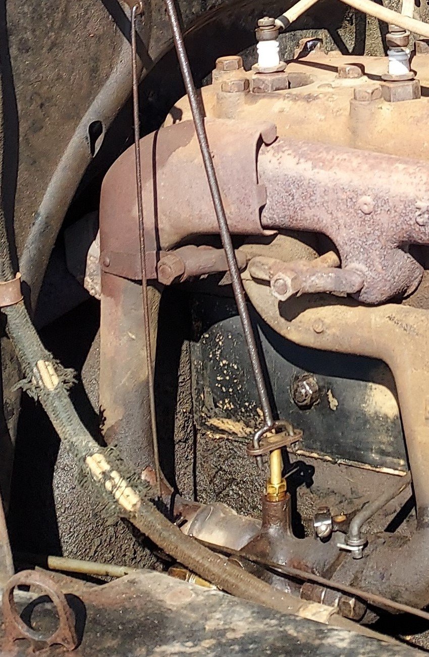

by Scott C.
It is for the later version with the swivel top carburetor control rod. Here is a picture of my 25 roadster pick up.

by John kuehn
Sort of typical what Ford would do to keep the transition of cars and their parts going to the next models.
Changes in the fender bracket holes in the frames, updating fender brackets, battery bracket holes, open car windshield brackets and etc The firewall updates also as we see here. I have a 24 Coupe and wandered about the extra hole too. Learning about Model T’s and finding out things were transitioning all the time. And the assembly just kept moving along!
By the way I used the extra hole to attach one end of a cut down screen door spring and the other end to the arm of the carburetor choke arm. The carb choke plate arm spring was broke and attaching the spring end to the arm worked pretty good when I choked the carb!
