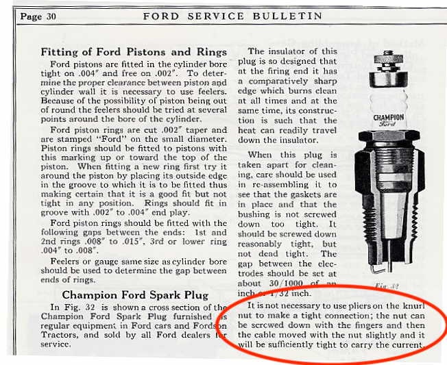

Ford Service tells the proper way to tighten, just with fingers on run down thumb nut, and push the wire lead to snug up, no pliers needed.

I must admit I did use small pliers on the old ones a couple of times, even on the Champion 25 I used as a spare. Bad move! Thanks for the tip 🙂 my leads sometimes still felt loose doing them by hand 🤔
