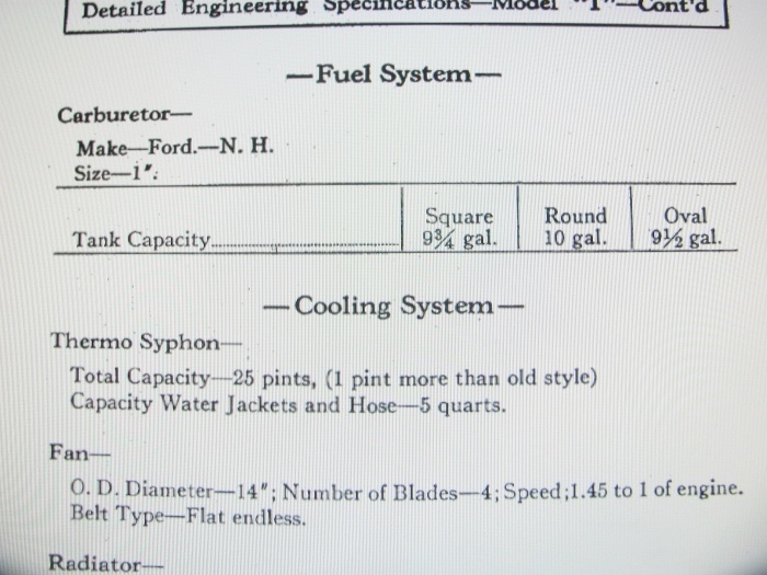

by DanTreace
Approx. 9 1/2 - 9 3/4 gallons.
Anymore than that it may over spill when using a gas pump nozzle. And place nozzle away from the baffle side or you will get some splash back if the pump is fast flowing :shock:
The earlier tank designs capacity.

9.75 gallons, and if you fill your tank that far, you'll have a gasoliney mess...
Get one of the tank dip sticks... run your car at 9 gallons...
