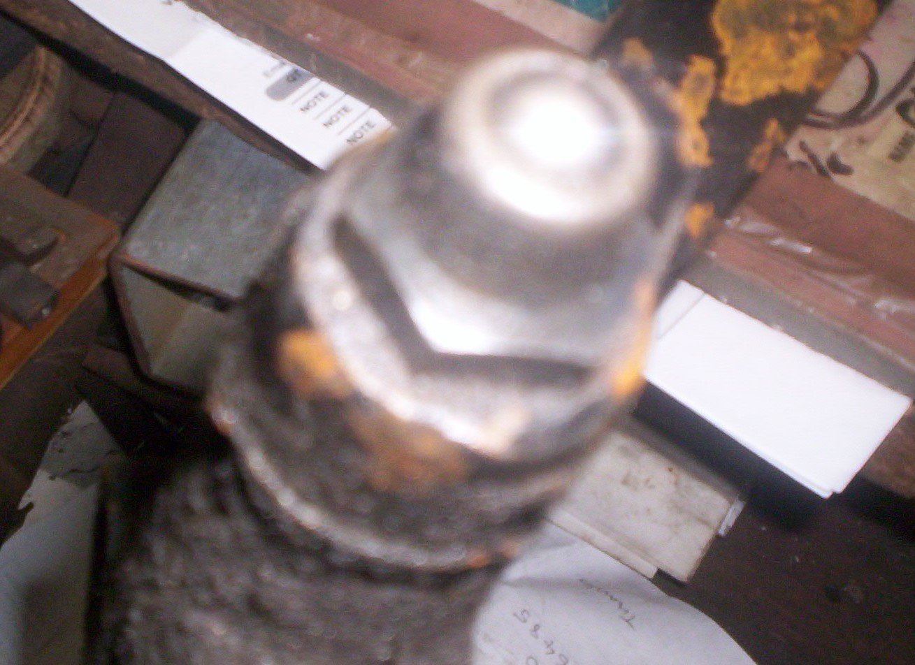

Just to confuse some more, Frank's list of time frame changes, shows that in 7-24-1914 that the spindle bolt re-designed to incorporate a built-in oiler. This spindle was in my 16, the spring and ball is built in the spindle as a one-piece unit.
