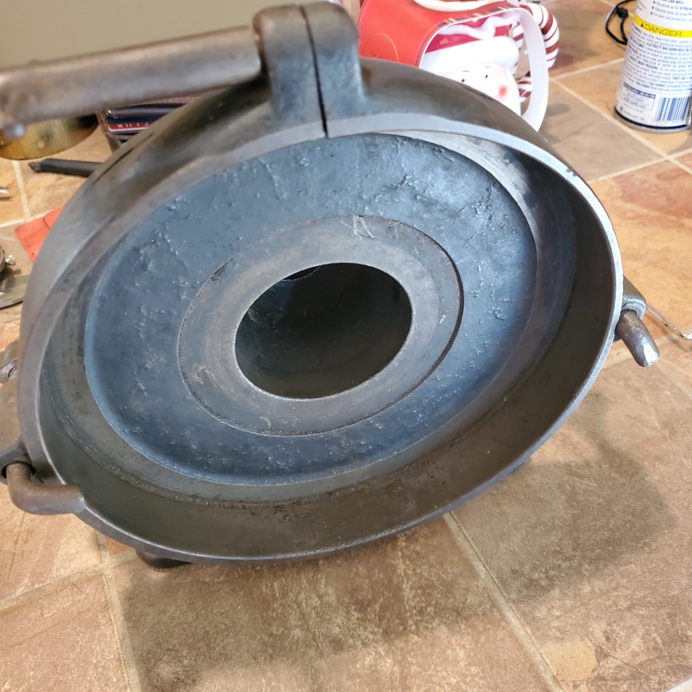

Need to clean these parts. What's the best and easiest cleaning method to use at home?

I would not bother "cleaning" them up. Let them tell their story as they are. By all means clean any machined surfaces so that they are accurate and easy to use. As someone once said, " They are only original once."

You don't have to bore or ream needle bearings!!
:shock: :shock:
Zep Industrial Purple and some scotch brite or steel wool works pretty well with hot water.

Update. Zep Industrial Purple worked wonders. Still need to oil the rod jig. Thank you Dan.
