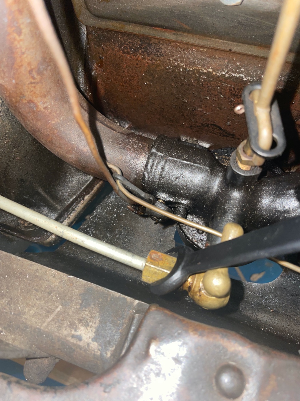

Anyone have ideas how to tighten the encircled nut.
It is 5/8 across the flats and a normal
5/8 end wrench is very ackward.

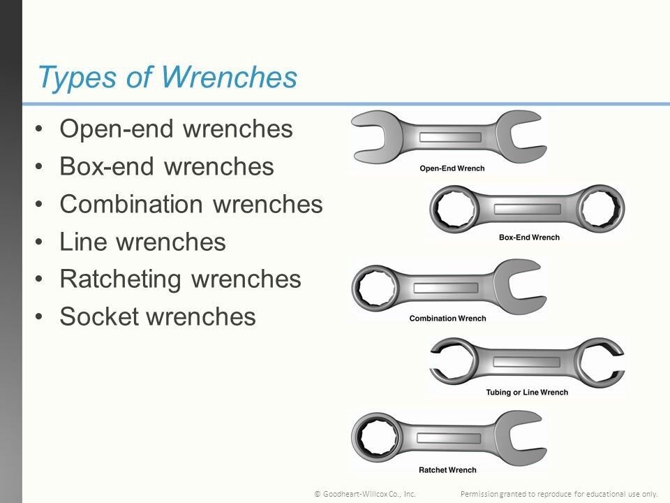

by jiminbartow
The 4th wrench down, the “tubing or line wrench” is what you need. It is basically a 6 sided box end wrench that has a slot cut out of it to allow it to fit over the tube then slides onto the nut.
You can make one of these by using a Dremel tool with a metal cutting disc to cut a piece out of a thin walled, 12 sided box end wrench, wide enough to allow it to clear the tube, then you can slide it onto the hex fitting. With a slotted box end wrench you have 12 sides instead of 6 so you don’t have to turn it so much during repositioning. Turn it, slide it off, reposition, slide it back on, turn it, etc. Jim Patrick
