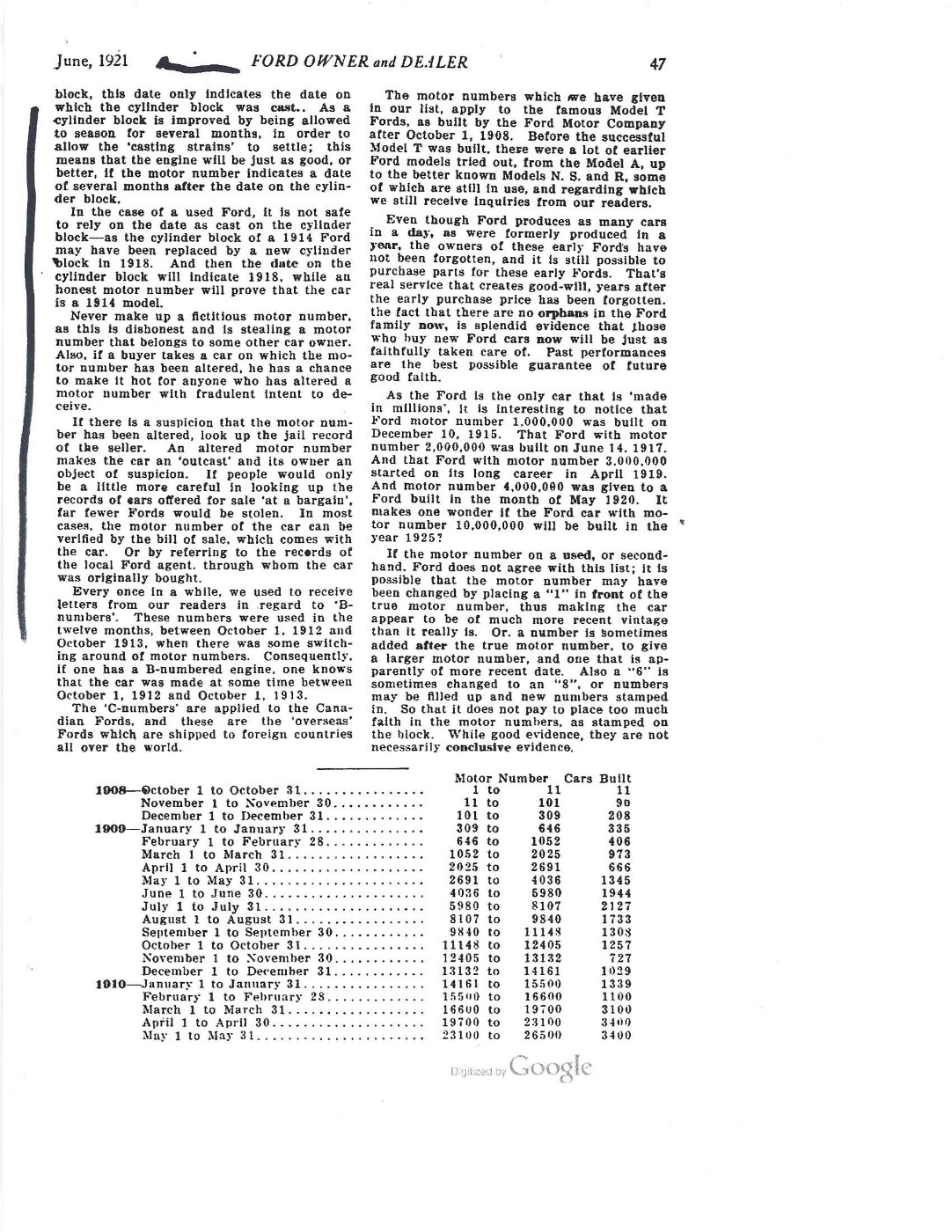

Every Model T Ford Owner has wondered the year and production and country of origin of their car. The Ford Owner every few years would give information on production numbers, identification of point of manufacture and more. This information was also reproduced in the Motor, Chilton, etc.
Attach is from Ford Owner and Dealer for 1921 June.
For example, the commonwealth nations received cars from Canada and the numbers in those nations were Canadian cars.
The information found in the current history on production came from publications similar to Ford Owner.
My assumption is there was a period pre-introduction of the improved Ford, Earlier Fords were sold as much newer cars as the unwary did not know that motor numbers indicated production year and if motors were changed so was the model year.
I am certain that as today, folks looking for a car in the 1920's saw a Model T and have stated, "They all look alike to me."
