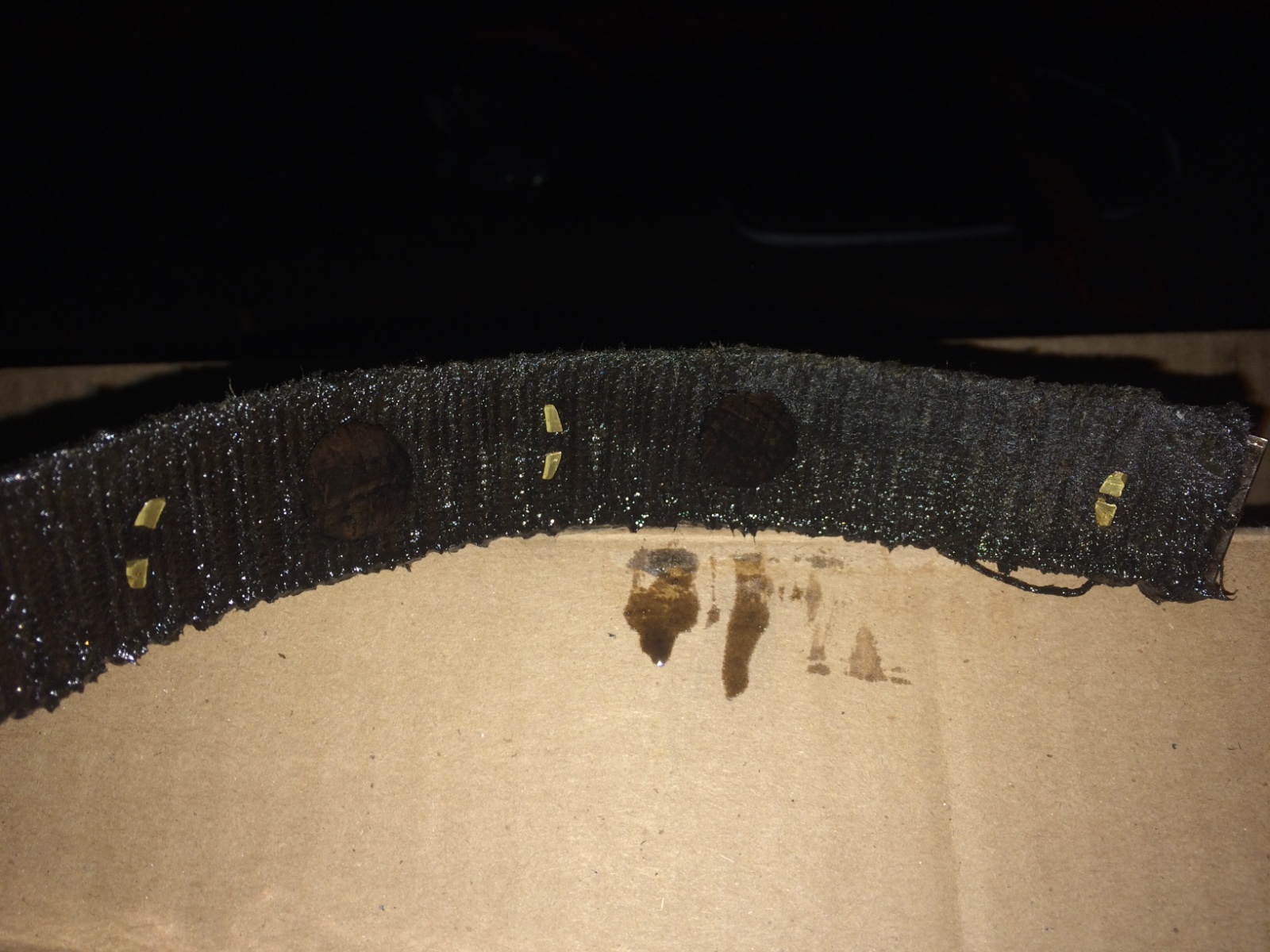

Went ahead and got the brake and low bands out.
Used mostly some bubble wrap to protect from the dreaded MIA washer/nut, worked good. :)
One piece of cork was no longer there, before or after ???
I really like the way the cork feels and wears pretty good, considering the same thing. Just a couple on the ends is what Pop did.
The low band was worn, but not scary yet. :?
