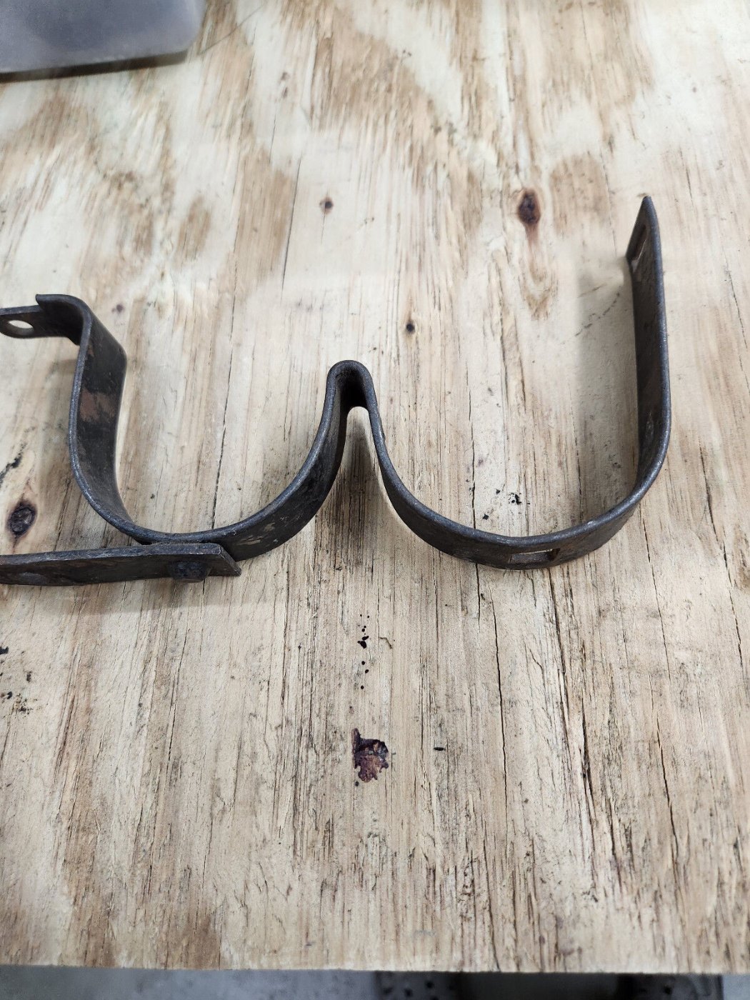

by Retro54
Here is the one I picked up at Hershey a few years ago. I am certain one could reproduce these.
Andy
