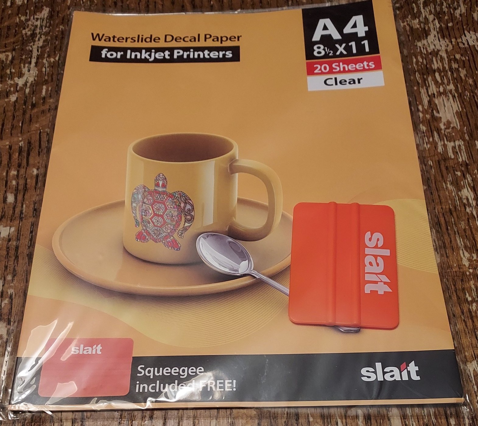

You might try to make your own decals. I am assuming Waterslide will work for you. You need to read details for the products. I did by some paper several years back when I had an inkjet printer. Now have color lazser
Anyway looks like the price is right https://www.google.com/search?client=fi ... ecal+paper+
Re: Varnish Transfer Decals
Posted: Wed Jan 31, 2024 7:16 am
by Humblej
You can make your own water slide decal if you have an inkjet printer. One limitation is the color white since home quality printers do not print white. You can get clear background decal sheet or white background decal sheet at some office supply stores.
