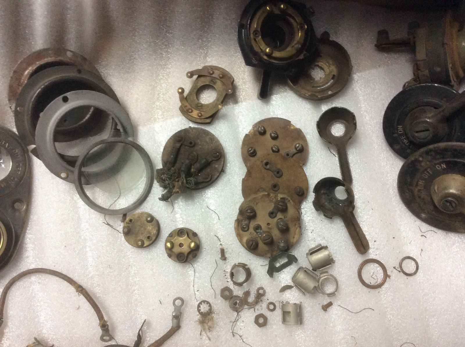

Covet your original lock cylinders if they are in good shape. The reproductions are really crappy and need a lot of rework to become usable. It would help if the maker did not put the heavy crappy plating job on the tumbler as most of that needs to be machined or ground off to have any chance of working...............I’ll post a picture, as I have a pile of parts, and if something looks like it would help, I’ll send it off to you. I know the removable fiber disc with contacts come in two styles, one with brass pins around the edge, and the other with notches. Lots of different makers of these originally and not all parts interchange. In fact, most do not. Cute little truck, enjoy!

Tmorsher@icloud.com to reach me
