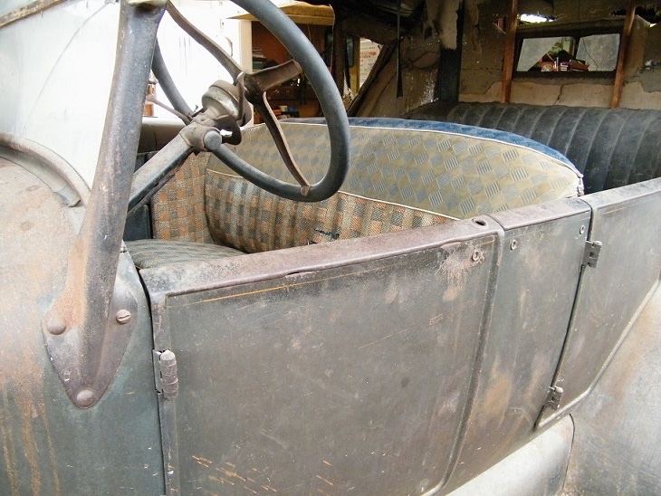

Original photo in the museum in 1929 or so. The lettering was silver on the blue body, note the stripe. Stripes were cream, green, orange, or vermilion red, depending on body color.
1929 photo
With only the colored Pyroxylin Improved open cars, a stripe was added. The stripe is very narrow and runs from the front door vertical bead, around but not over the beads of the rear doors, but all around the rear of the touring.

Thanks for the pictures. My computer does not allow me to blow up the picture and see the pin striping. It gets to fuzzy.
Your second picture with the vehicle with the front seat cover shows how the pin striping starts at the front of the front door after the bead. I assume the striping on the open cars is mostly horizontal, not like a coupe that has some vertical striping?
However, that second picture brings up another question. One of the screws of the window stanchion is slotted. Does the back of this screw have a square under its head like a carriage bolt? If so, what would be the purpose of the screw slot as one could not rotate the fastener' If one can rotate the fastener Ford would need an extra operation to hole the screw from rotating. I have see this slotted screw in the same position on a number of original open cars so I think this is something done by Ford. Is it for a clip to hold a side curtain or gypsy curtain in place?

The single slot screw on the stanchion is correct factory fitting. The curtain hook has round hole, so machine screw was used. Plus if you have tried to install a nut there , on a captive carriage bolt, you will soon know why a slotted screw was used from the outside. :roll:
