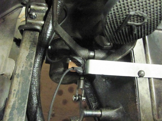

The simple one fitted to the inspection cover works well. Lang's sells this style, a copy of original one. Easy to adjust the location of the push switch as it is held with a single nut, adjust to outward travel of the brake pedal.
Of course you have to remove to inspect the oil screen, but no big deal if you insulate the terminal wires to prevent contact, or remove the yellow wire from the gang terminal on the fire wall, that shuts off all DC voltage.
As for the Bendix cover version, the contacts and insulation washers in that made in foreign land are poor, and have had one cook itself when connected to dual brake lights, too much amp or something, didn't last long.
